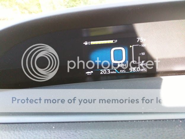

    I can go all electric at 70, did it this morning on the drive in to work. The electric propulsion is amazingly efficient, even at higher speeds I can keep the car on battery for a long time w/o killing battery immediately if I am careful with accelerator. Have to modulate with right foot to minimize current draw. Here are a couple from last year, just watched speed and tried to time lights so I never came to a complete stop.
    [​IMG] [​IMG] [​IMG]
    RCO likes this.
