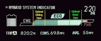

    EXACTLY! Look at the HSI Indicator. When EV is not lit, the ICE is burning fuel. Cut and dry. No mysteries here.
    Ice is OFF when HSI looks like above.
    Ron (dorunron)

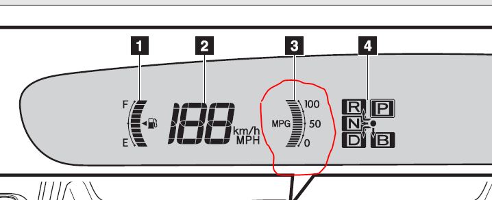

    When the instantaneous fuel consumption gauge (circled) is up to the top (or down to the bottom with liters/100km), and you're below ~45 mph, the engine's off. Above 45 mph my Scanguage will show minimum 900+ rpm, but the IFC gauge (and Scangauge) will show no gas being consumed. So maybe it's just turning over.

    On US models, scaled in MPG, that is not definitive. In certain circumstances the car can be burning fuel as low as 0.2 gallon/hour, getting 100-300 mpg, and it will still peg that display the same as the no fuel condition.
    If your Canadian (or almost anywhere else in the world, except Japan) car is scaled in liters/100km, then this display should be definitive, as either zero or not-zero fuel consumption.
    This is another reason I hate the US MPG scale. If we can't go metric, then at least we should replace MPG with Gallons/100miles. That would get rid of many misunderstandings among the non-mathematician consumers.
    On my Prius, 992 rpm means no fuel. Any fuel burn displayed on GPH appears to create a higher rpm.
