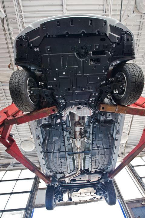

    I am trying to jack my car higher but my floor jack cannot jack high enough at the usual side and the middle knob near the engine.
    Anyone know where else I can jack the car safely? I can put block of wood but it still have to be stable enough so that I can jack high enough to put in my jack stands.
    Both front and back. Thanks.
    Edit:
    Front this picture, the front point where it was jacked, looks like it's the lower arm connection point. Is that safe?
    #1 abubin, Dec 27, 2021

    I need as much clearance as I can get from my jack stand. Yes, I will place a wood block under the jack but it still need to be jacked from somewhere safe. The side doesn't work as there is the protruding pinch weld (not sure what it's called). I have a few idea but would like to get more opinion on the safest method. Safety most important.
