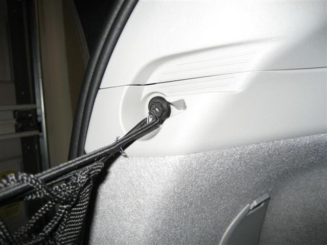

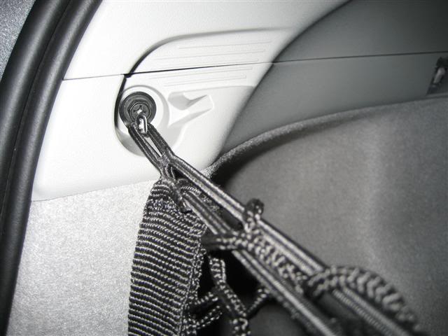

    Toyota put out T-SB-0347-09 which is titled "Cargo Net Trim Panel Gap." It stated that "Installation of the accessory cargo net may cause a gap to occur between the left or right interior lower quarter panel and upper quarter panel trim. A new cargo net hook and mounting location have been developed to address this concern."
    The TSB then listed "Parts Information" and said that the new part number is PT347-47100-FK and that the part is called the "Cargo Net Repair Kit."
    Dealers may or may not have them in stock, but should be able to get them for you if they don't have 'em. It's arguable that Toyota should provide them free of charge to those who bought the Toyota net.

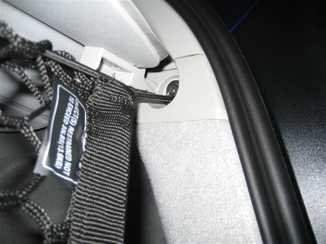

    Just thought I would post a quick, easy, CHEAP fix, since the dealer wanted to charge me $22 for the "new" hooks...
    These are actually wall hooks that I bought for $2.57 at Wal-Mart (in the picture hanging/hardware dept.), just some slight bending with a pair of needle nose pliers, and that was it! Works great, and looks almost exactly like the "new style" hooks from Toyota. And it does not interfere with the trunk cover at all!
    I posted a picture of the packaging, but I forgot to take the picture before I took the hooks out...
    [Broken External Image]:http://i981.photobucket.com/albums/ae299/nchs021/IMG_1869_.jpg

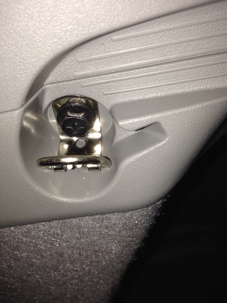

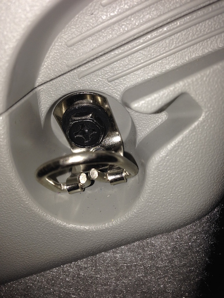

    Got these at Home Depot, bent the tab and they work great, like factory, real cheap, and they swivel out of the way for cargo cover or just to get out of the way. IMG_1195.jpg View attachment 70149 IMG_1196.jpg
