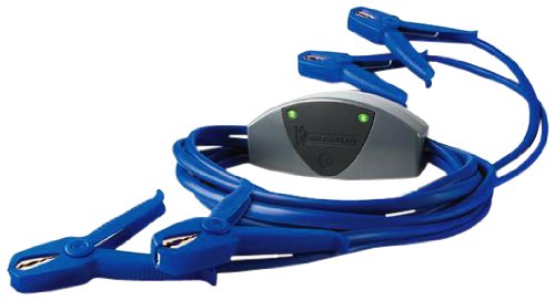

    Another great reason to buy these:
    Polarity agnostic cables that have a delayed connection so no sparks, no reverse polarity, nothing. And perfect for the Prius. I don't think they make this exact model anymore, but they do make them. They are called "Smart Jumper Cables"

    I can't find these or anything like these on Amazon or doing a Google search. There's another brand called Astro Pneumatic that are also out of stock everywhere. Seems they've either all sold out or have been pulled from the market.
    Update: Found some Astro Pneumatic and another brand on eBay...still haven't located the Michelins.
