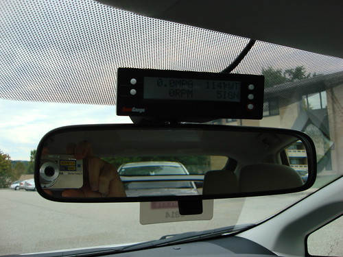

    I got a Blendmount for mine. It sits right above my rear view mirror.
    ScanGaugeII -- MGT Motorsports Online Store
    Here is a picture of my Scangauge mounted.
    The upside is from the front or side you can't see the Scan Gauge from outside of the car unless your are actively looking for it.

    It was an easy routing BTW.
    At the top the with your fingers pull the front edge of the headliner (felt covered plastic) down just enough to push or squeeze the cable inside. When you get to the left side edge by the drivers door window and the windshield you do the same thing with the top corner (A pillar) of plastic piece holding the front side air bag. Pull it out at the top edge just enough to squeeze the cable in NO MORE. It is maybe an inch and a half total distance or width of the panel that the cable hides behind this piece. From there Toyota made it very easy to route the cable to the bottom.
    When you open the door you will see a rubber gasket 3/4 to an inch wide that runs from the top to the bottom of the door frame in the front.The cable will easily slip under this gasket to the floor. From the bottom of the door you will see a kick panel to the left that you can squeeze the cable behind and up under the dash to the OBDII port. A zip tie or two will keep the cable secured up under the dash.
    It took me about 15 minutes to install including how to figure out how to route the cable to the port. Should take you less since I told you how to route the cable to the OBDII port. :p It looks like a factory install when your done. The only exposed part of the cable is from the headliner to the unit itself.
