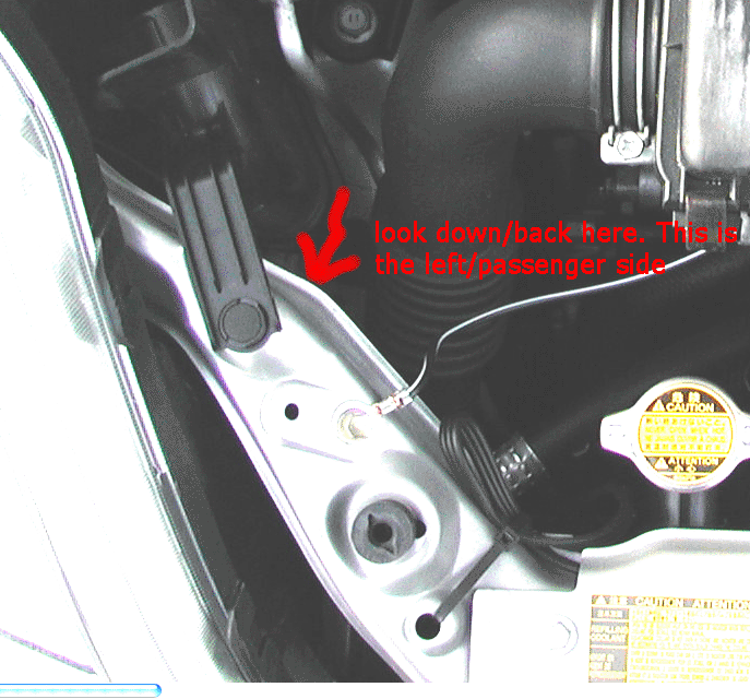

    SUCCESS!!!! And none too soon, as I was flashed (no, not that kind) no fewer than 4 times tonight. Let's see I've driven for over 35 years and literally NEVER been flashed once. I buy a Prius and it happened DAILY, er uh, NIGHTLY!
    THANK YOU FRANK. Those lights were W A Y O U T OF Non-Blinding ALIGNMENT. Oddly enough I used a 5/16 socket (1/4"driver w/360 swivel) to do most of the turning of the hex head bolt which is part of the Star Nut Assy. I also gripped the passenger side Star Nut Assy with my mighty fingers and adjusted the headlight. I wasn't able to do that on the driver's side.
    I took the rig out for a 'headlight test run' and stopped several times to readjust the light pattern to eliminate BLINDING PEOPLE with the previously UPWARD pointing, way out of alignment, headlamps.
    If you have the inclination, ADJUST YOUR OWN!!!
