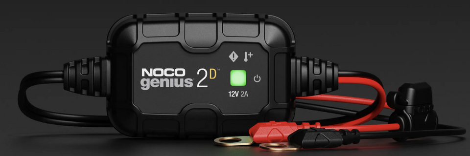

    The 2 amp NOCO I referenced above is a direct mount:

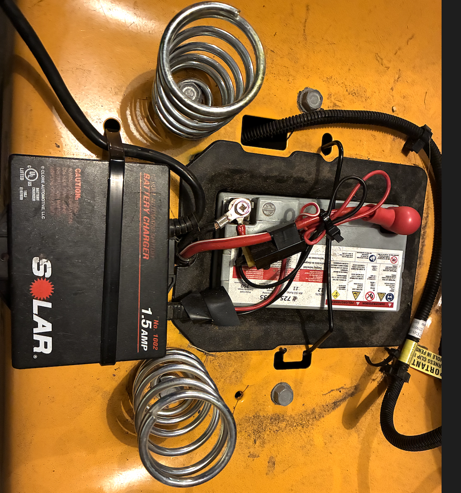

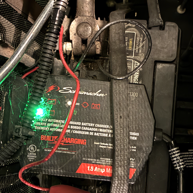

    Also, I just recently brought back from the dead a two year old lawn tractor battery, with an old 1.5 Amp 'Solar' charger. It used to reside under the hood in an old truck that I didn't use that much. I usually plug the tractor in. I did a lot of stop/starts and didn't plug it in-that lawn tractor battery is tiny.
    I also have a 1.5 Amp charger under the hood of my Deere subcompact tractor, and keep it plugged in. I only really use it for snow removal.

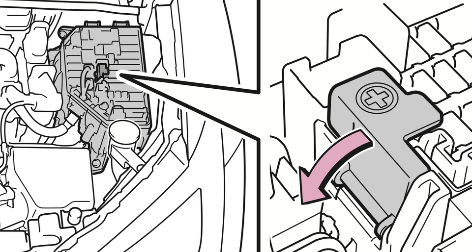

    It comes with a mounting strap that mounts to any surface with 2 screws. I didn't trust the alligator clips, so I removed them, and used the ring terminals instead. There is a 10 mm nut on a stud in the fusebox that is live to the battery, which I connected to.

    Your battery is under the hood, right? That'd be the place to tie in a permanent mount battery I would think.
    The new cars have the battery in the back with a + terminal on top of the fuse box for jumping the car. Paul has found a live bolt to attach the maintainer. If it was me, maybe, I might keep the cord inside rather than route it to the grille: it would protect the plug and I'd leave the hood up overnight (in the garage) so I wouldn't forget to unplug it in the morning.
