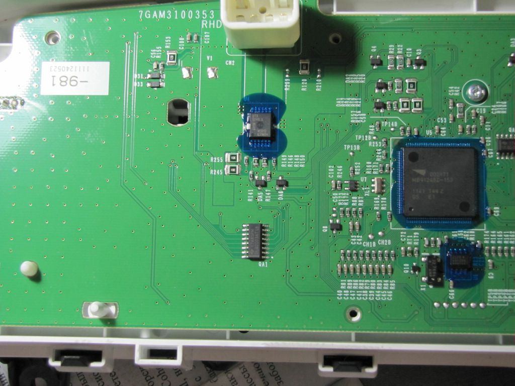

    Instead of flasher using chip BTS 5240 L. It is installed in the speedometr.
    How to fix hyperblinking in this case?

  20. AlexSmall
    AlexSmall Junior Member
    Jul 24, 2016
    Krakow
    2013 Prius+ MPV
    Hey!
    I have fixed integrated into Prius+(PriusV) flasher.
    By replacing 2.2k resistors to 10k.
    Here is more details and pictures (it is in russian :) ) I can't post link :(
    ozjimjam likes this.
