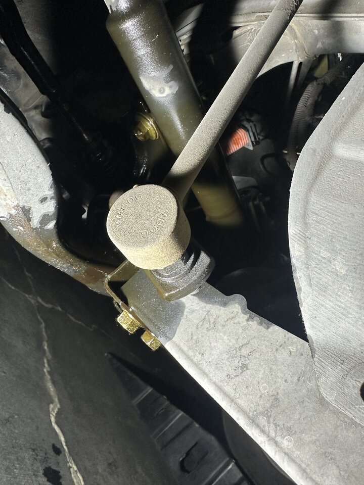

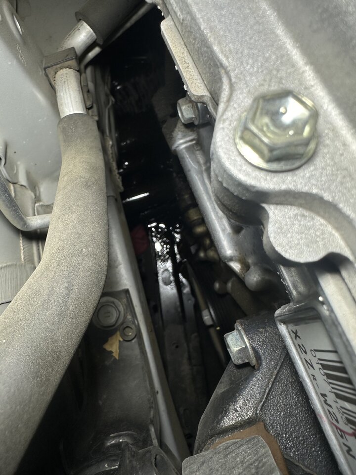

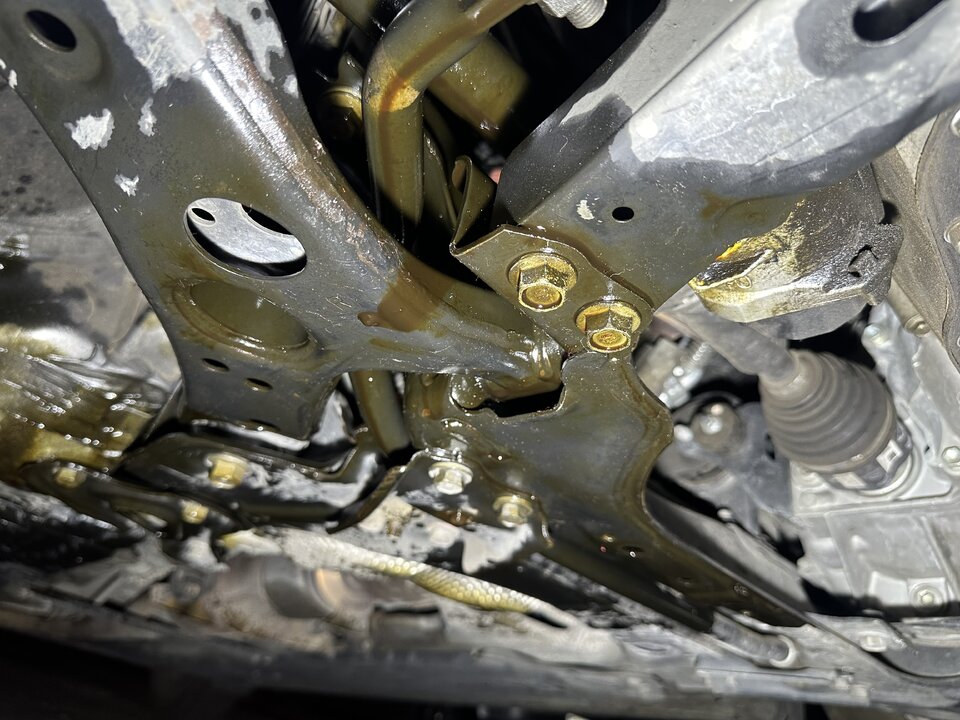

    I’m in need of help please! I smelled burning oil after driving my Prius so I looked under and found a puddle of oil under the engine dripping onto the passenger transaxle and even further back behind it would stream out once engine stopped.
    Tried getting some pics but it’s dark out; maybe you guys are familiar with this and could point me in the right direction!
    Car is a 2011 has about 230k miles on it everything else is bone dry including oil pan and filter housing.

    I checked and the oil pan/housing is completely dry. I can’t see where the leak is coming from it’s in a crowded spot and leaks a little at a time

    The color looks more like it's an axle CV joint boot that's leaking lubricant. The joint by the transaxle looks totally dry. What about the joint at the front suspension? I'm just going by the first photo, the other two are messing my brain up. May not make sense with your other symptoms, like dripping on the transaxle and leaking after the engine is stopped, but weird things happen sometimes.

    Just easier to view:
    If I'm not mistaken, they're all at the left end, as you stand at front of engine bay? This zone is technically known as the "front" of the engine.
    Timing chain tensioner, oil pressure sensor, or timing chain cover?

    That sounds about right. Front of engine towards the firewall.
    You'll need to hose down the area with degreaser and get a couple cans of brake cleaner too. Put the car up on ramps, clean it off to track down the leak. My money's on the timing cover where the head meets the lower engine block. Use the cans of brake clean to spot clean the questionable areas you couldn't get to with the water hose.
