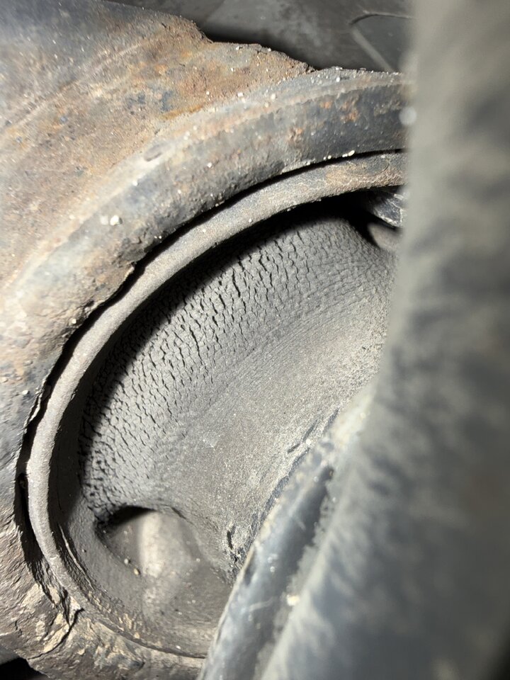

    I recently got 300k km on my 2012 Prius. I checked rear suspension trailing arm bushings and they may need to be replaced. I could not find a tool online to remove and install them.
    The part I want to replace is called
    BUSH, REAR AXLE CARRIER Genuine Toyota (4872547030)
    Thanks in advance.
