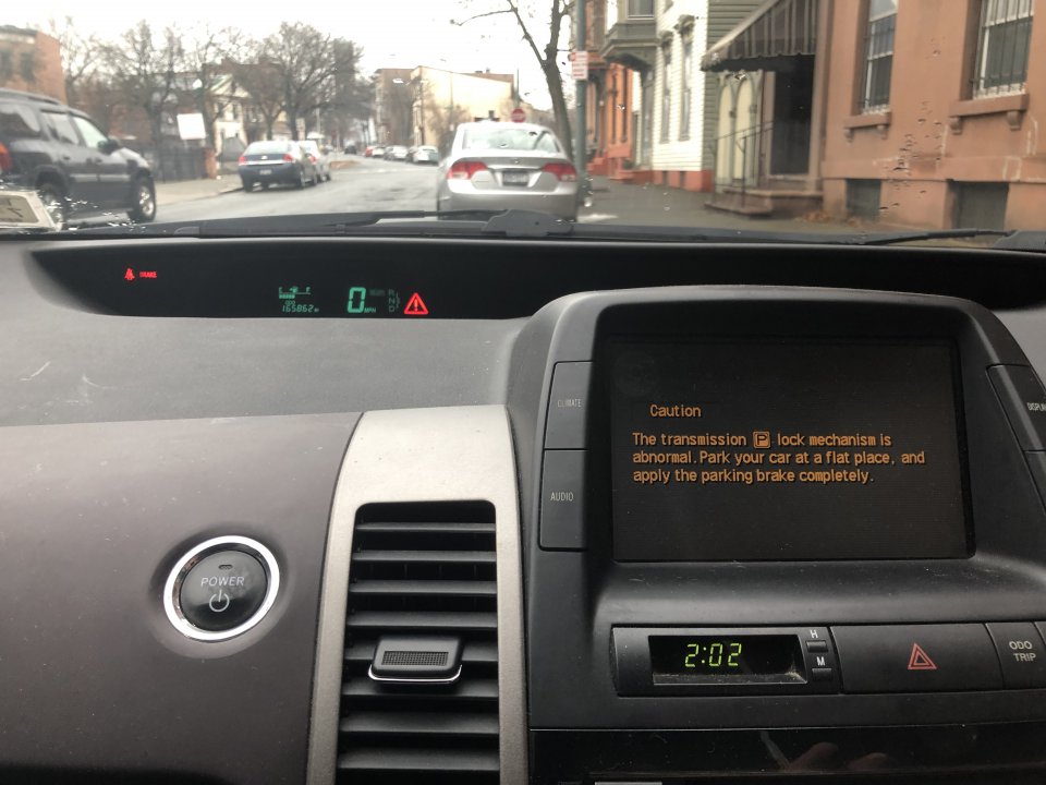

    Tried starting it up since I park on the street and need to move for tomorrow, and it proceeded to do the following: (see photos)
    Not a happy car. The green P(arking) light was flashing on and off.

    This is what happened to me last month with the lights, message, and everything. The remedy was EXTREMELY SIMPLE and only took ONE STEP.
    Did you follow the instructions on the screen????
    What I did was depress the parking brake all the way down into the floor mat per the message (yes, it really is that simple), the cars computer resets, and the DTCs go away. Drive as normal.

    Good question. Evidently it's something that occurs when the 12v battery is so drained that the sensor cannot ascertain whether the brake is fully engaged or not.
    I checked this morning, and my 12v battery is only 4.8-8.3 volts. I couldn't even go in and check via the accessory mode. Don't want to go back to PepBoys to have them check whether there's something else wrong besides a junk 12v battery... whether it's the HV battery or the DC-DC inverter. I ended up bringing it to a local shop that has someone trained in hybrids. Jumped and drove it there. They'll get to it this week and I hope to know more!

    IIRC it is referring to the emergency brake (the one with the small lever in the leftmost area of the footwell). It only makes sense because if the computer detects and issue with the parking pawl, it cannot be sure that the car will not roll away. Thus, the emergency brake would need to be applied.
  13. ChapmanF
    28,636
    18,959
    It's the one with the pedal that ratchets down and locks, so it can hold the car in one place when it's parked and you're not in it to hold the pedal down.
    It doesn't make a great emergency brake really; too easy to lose control trying to brake a moving car with a ratcheting-pedal parking brake, unless you have the presence-of-mind-under-pressure to double-press it right at first so the ratchet's off. If it was the only way to not fall in the river, yeah, I guess I'd use it....
    While it's fun that toymo's issue seemed to go away, in connection with applying the parking brake, that's really just how it worked out in that case. It doesn't mean applying the parking brake 'resets' something, or fixes the P lock problem.
    The reason the MFD message tells you to apply the parking brake, when the transmission P lock isn't working, is to keep your car from rolling away, since without the P lock working, nothing else is going to do that.
    A very common reason for a P lock error to be logged is aux battery voltage too low to work the P lock motor. "4.8-8.3 volts" definitely qualifies as too low. Take care of that problem and any P lock issues will probably be solved.

    ... when the transmission control ECU complains about low voltage, it's complaining about low voltage at the transmission control ECU ... which could be very much about wiring, connectors, or other sources of voltage drop, and not an automatic guilty verdict for the battery. Has to be tracked down.
    But didn't Syl say 4.8 to 8.3 volts were measured at the battery? Again, even that doesn't necessarily mean the battery's the ultimate culprit. Maybe it's not getting charged. But that's easy to test. Is it 13.8 or so back there when the car is READY?
    Either way, the battery will be happier with some charge pumped back in....

    SURPRISE!!! Fuel sensor failure. According to them, my battery is testing fine at this point. They added fuel, and it was ok. But if the fuel sensor goes, and it thinks it has no fuel, the gas engine won't start and neither will the electric motor. Thus why my car was suddenly behaving oddly in the middle of the week? I'm not feeling psyched.
    Diagnostics, part and repair cost $1200. I'm expecting another shoe to drop if I repair this, and it'll be something else (too). They did say I could just keep it topped up and it should be ok at the moment.
