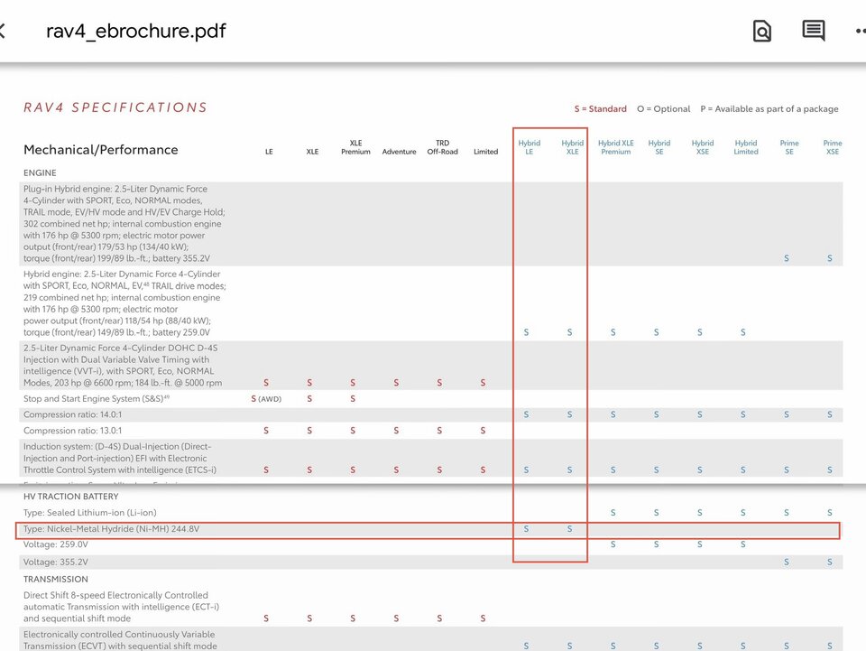

    Le, xle and woodland hybrids were nimh in 2025

    In 2022 nimh was hybrid le and xle. No guarantee on size, voltage or connections of modules but you could check with the sellers.
    For other years go to Toyota.com and download the rav4 ebrochure for a given year.

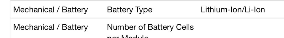

    Looking up RAV4's online, it appears to be contradictory.
    This is an SE with a 6 for 5th digit, which according to the spec sheet is LI, not NIMH.
    2022 Toyota RAV4 Hybrid - VIN: JTM16RFV5ND070779

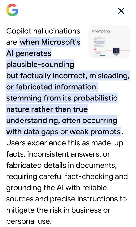

    Co-pilot is hallucinating again

    Yeah I know "AI" can be wrong, just didn't expect it to be that wrong lol. Thanks for info.
  10. indel
    indel Member
    Apr 1, 2024
    283
    89
    Northwest Indiana
    It can be blatantly wrong and still over confident. It will also profusely apologize for its mistakes and give you tremendous praise.

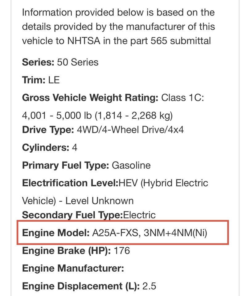

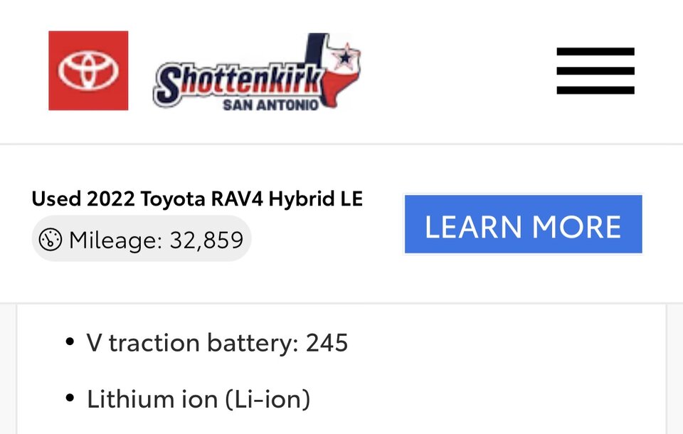

    A local Toyota dealer selling a 22 Rav4 Hybrid LE vin 4T3MWRFV9NU080540
    They list every spec in the book including the correct voltage (post 4 table) but get the battery type wrong - probably a salesman or manager that thinks all Rav4 hybrids of this generation are lithium.
    Meanwhile the government vin lookup for the above
    If I decided the 5th digit was the battery type it would be a letter in this case. Which may be accurate.
