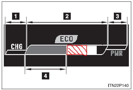

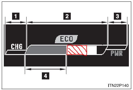

    In the linked and mentioned video by Wayne Gerdes, he mentions at one point that anywhere between 1/2 and 3/4's of the way along the eco zone is good acceleration range. I don't stick slavishly to that, but once through the initial kick, I try to keep it in that zone when accelerating. All bets are off on an uphill grade though.
    tpenny67 and Robert Holt like this.
  16. lexel
    lexel New Member
    Jan 21, 2015
    Yes this is the second part of methode 6) but i made the adaptation to be on the lower side of your red marking. Between the "C" and the "O". That was so far most efficient for that kind of acceleration from 30 to 50km/h.

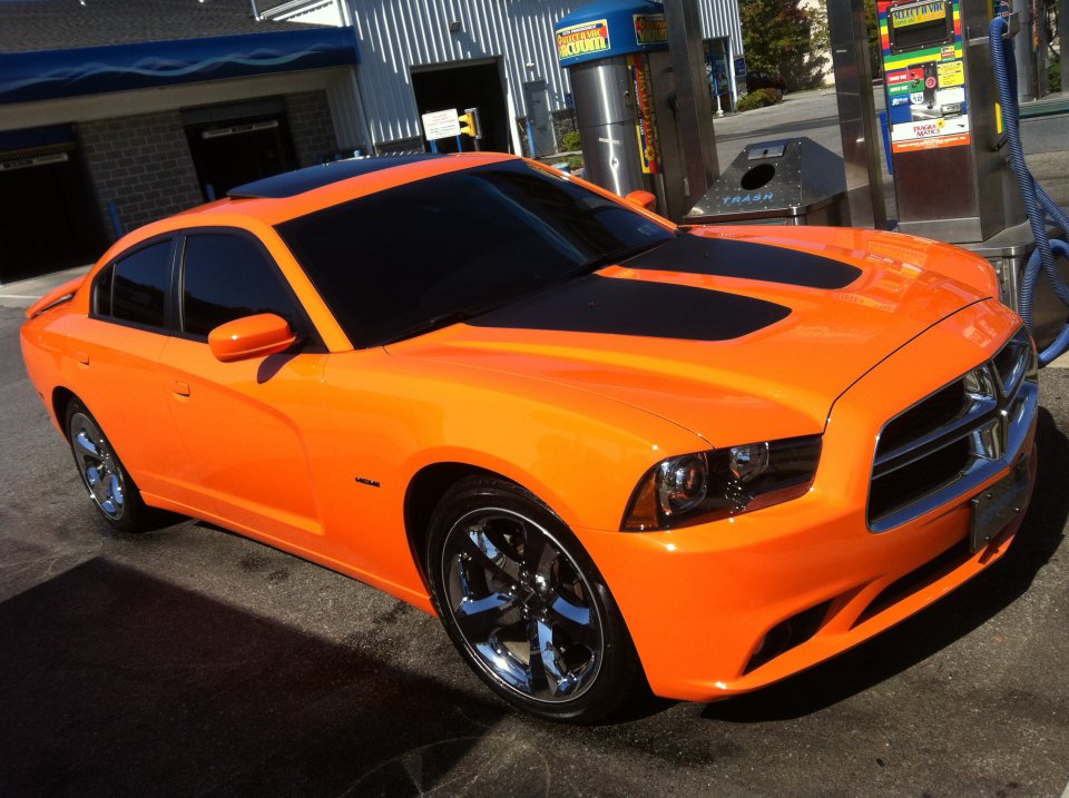

    image.jpg Used to own this beast! Used to not really care about what's in this thread (although I did keep track of the pitiful mpg religiously)..... Now I do... Keep up the good work all and thanks all for the good info on how to maximize potential.
