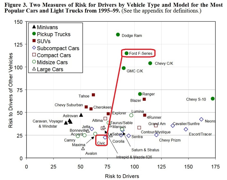

    Relevant to this topic is a re-run of a couple of my recent posts in another thread, concerning a report several decades ago, when standards where lower, pickups and SUVs still had much lower crash compatibility requirements than passenger cars, and their higher bumpers and grills frequently rode over the top of cars' protective structures to more deeply penetrate the passenger cabin.
    https://eta.lbl.gov/publications/analysis-traffic-deaths-vehicle-type
    "I remember reading the report Gokhan referenced back when it was first released. Here is one of its relevant charts. One thing that then jumped out at me was that the Honda Civic just as safe for its driver as a Ford Explorer, but twice as safe for the driver of the other vehicles it tangled with. Some other SUVs were a bit better for their own driver, but worse for the other drivers. All pickups scored worse, some far worse, on both measures."
    "That's what happened when customers defined "safety" as 'killing the other guy without killing yourself'. A paraphrase of an actual SUV owner interviewed in a 1990s Seattle Times article about the then-increasing popularity of SUVs.
    I added some markers to that chart posted back at #50, to illustrate the problem:
    [​IMG]"
    Another report of that same era (I haven't tracked down a modern link to it), confirmed that heavier vehicles in a given class were "safer" in multi-vehicle crashes, at least in the meaning of 'killing the other guy without killing yourself'. But when passenger cars and light trucks were tabulated separately, it also revealed that trucks were carrying a lot of 'wasted' weight not contributing to their own safety. I.e. cars were significantly safer than trucks of the same weight.
    That was at a time when cars had to meet a lot of federal crash safety regulations, but trucks were mostly still exempt. Federal requirements have since been very significantly tightened for both, and I haven't seen an equivalent study updated to modern models.
