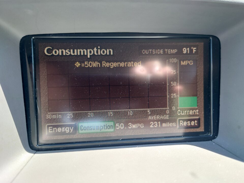

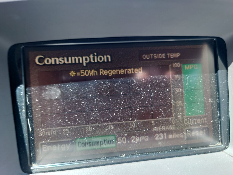

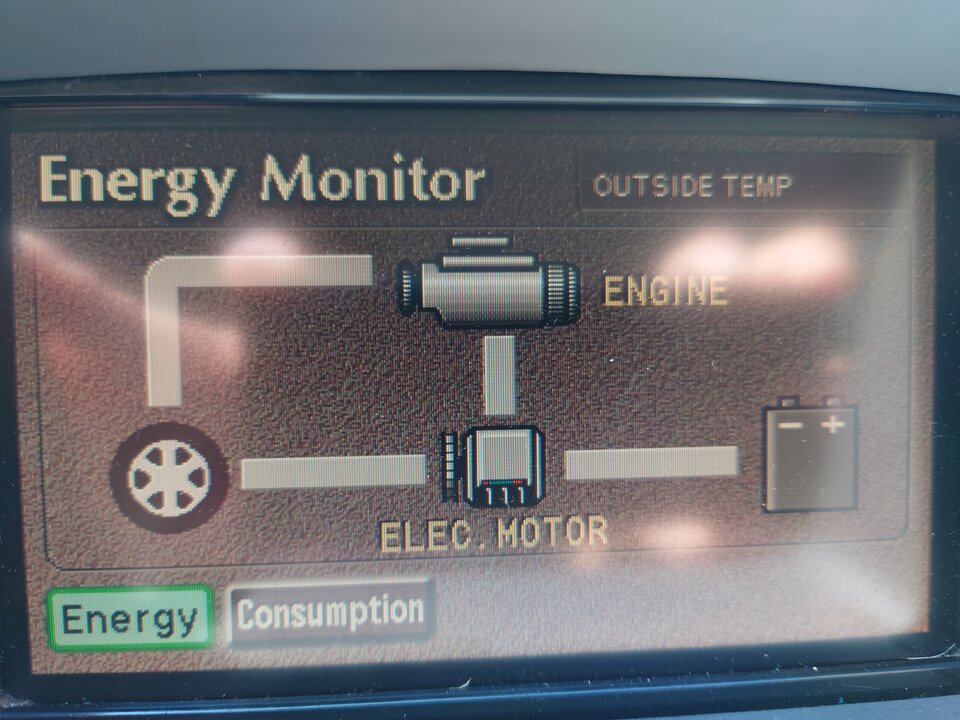

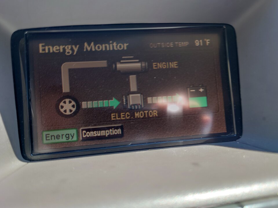

    This morning was the second time this happened. Both times were 'cold' starts when the outside temp was above 90F
    It took about 30 seconds once the TOYOTA screen went away for anything to appear on the screen, then...
    This is the energy monitor with car in READY, and driving about 20mph
    The consumption screen at this time was pegging at EV/infinite MPG at any speed over 5mph
    A few blocks later (3-5 min) all is well with the consumption and energy screens.

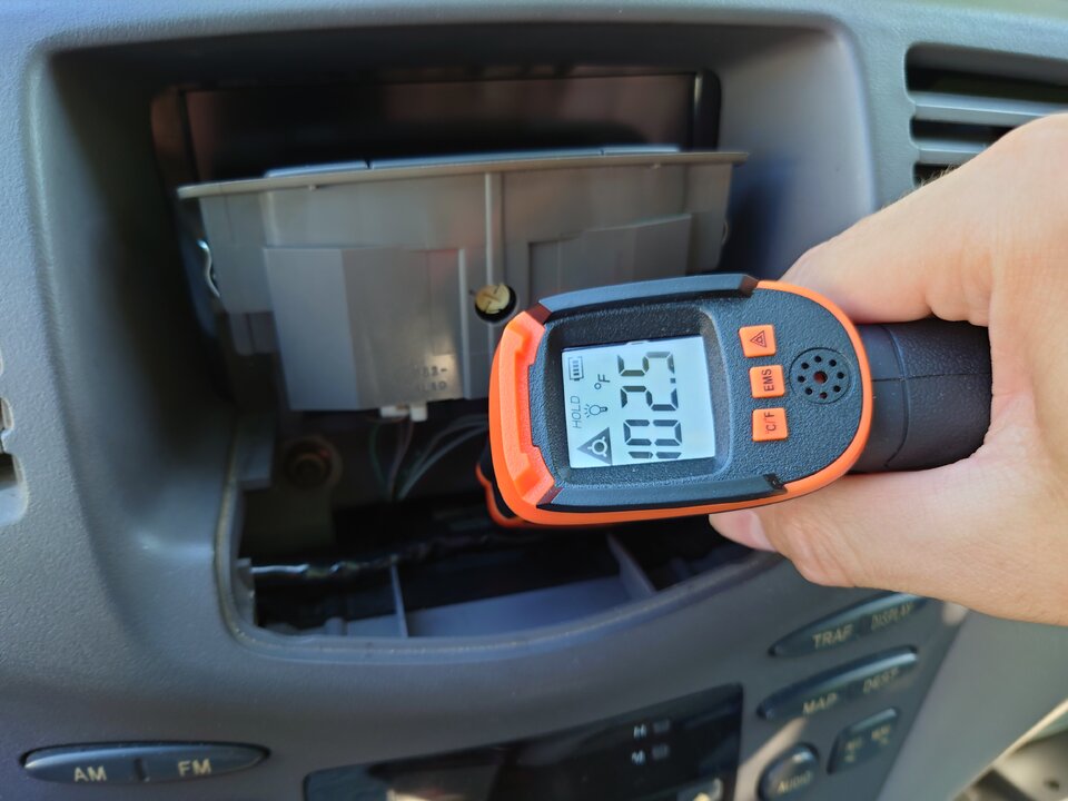

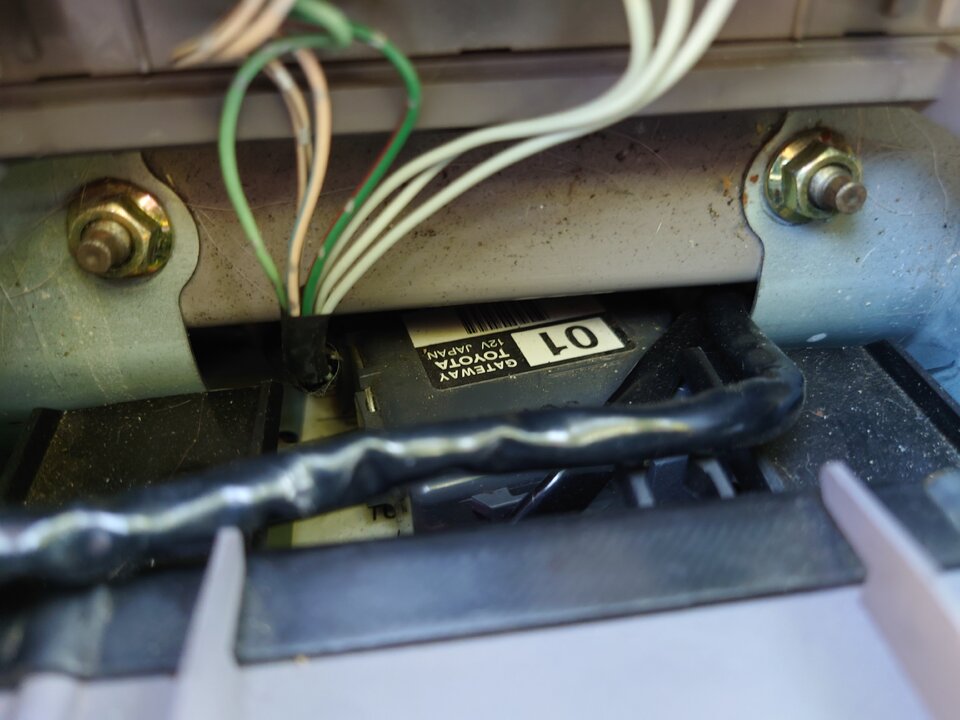

    I'm sure there are people here who maybe no longer own a Gen 1.5 who could explain it better than I can, but...

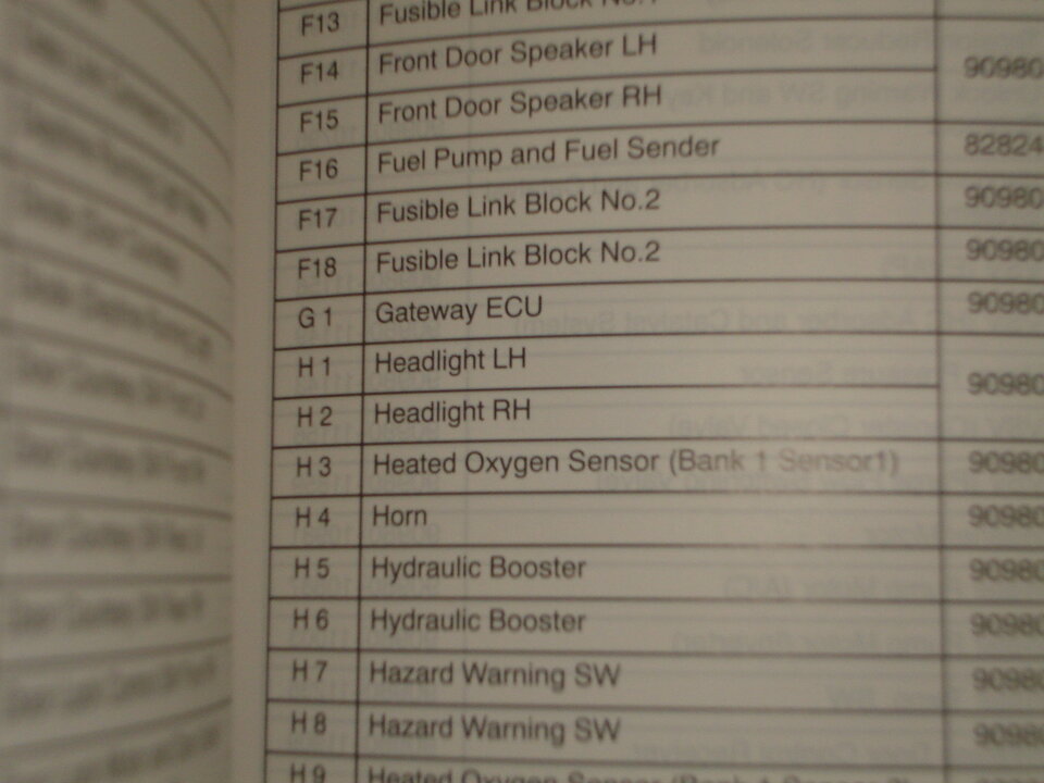

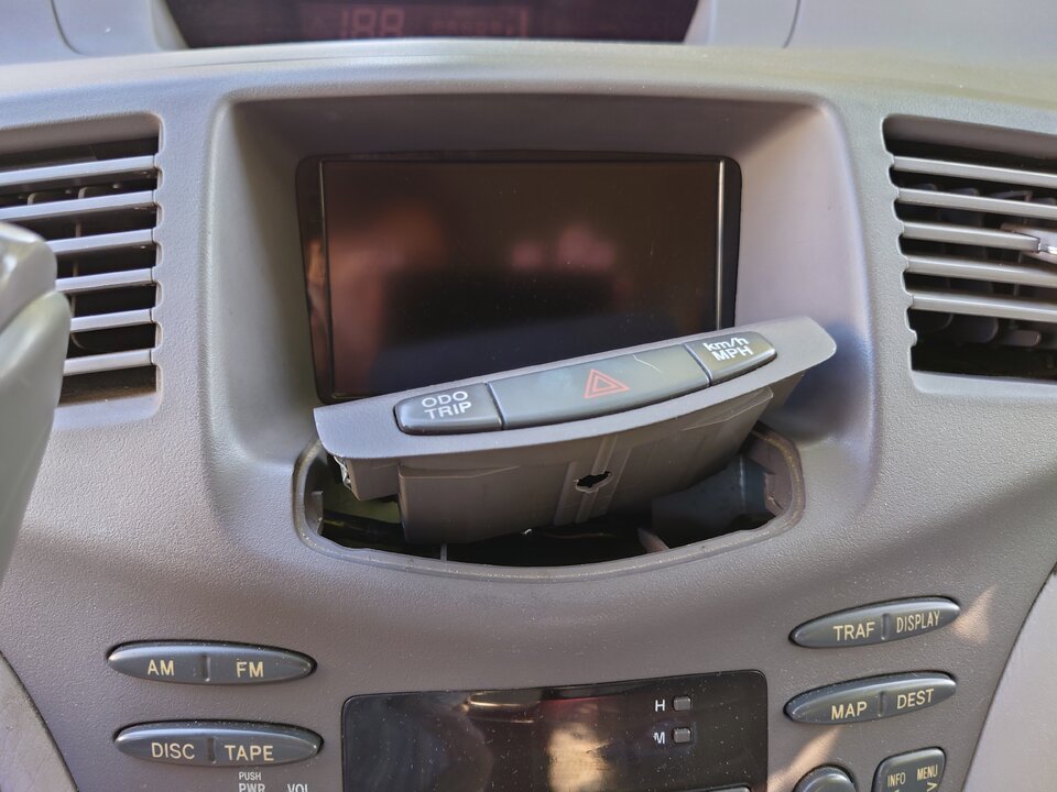

    It's this little bity black box located under the hazard button, easily visible by just popping that out.
    My car has been parked under a tree in the shade all day (high of 96F) it's currently about 88F where I am, and this box reads about 102-4F with the car off.

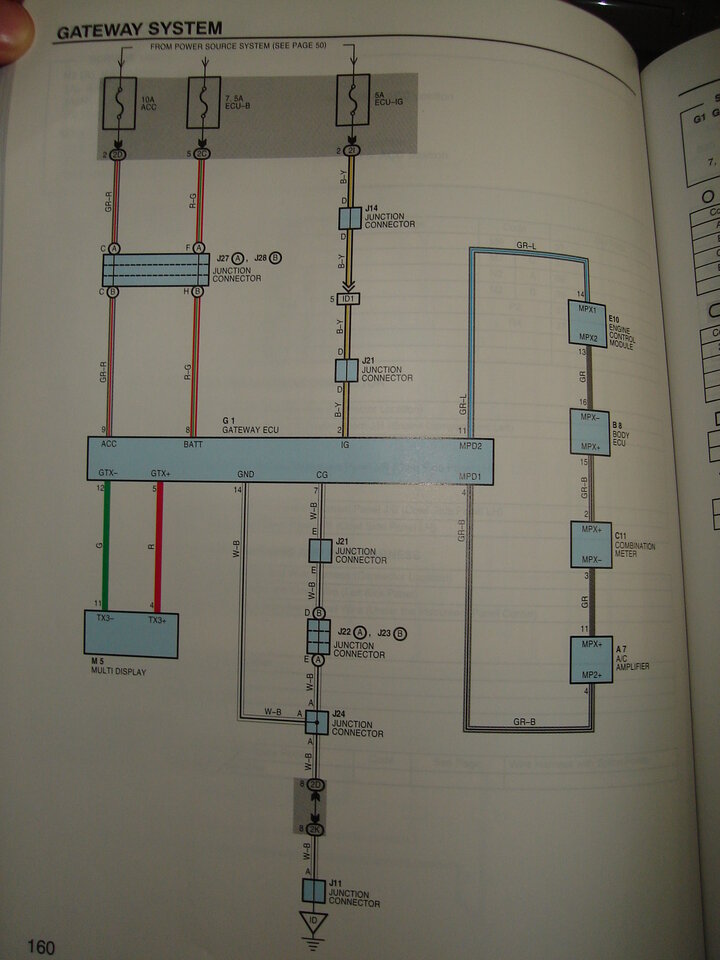

    From what I can decipher from the wiring diagram... the Gateway ECU takes inputs from the HV ECM, ICE ECM, Navigation System, Radio Amplifier (tape deck), and the Auto AC amplifier for some reason (maybe just to display the outside temp in the corner?)
    My theory for this Gateway ECU being the problem, is the fact that this seems to be the intersection of data visible on the screen. Also, given there are not OBD2/Techstream codes, or any running issues I doubt it has anything to do with the HV ECM or ICE ECM.
