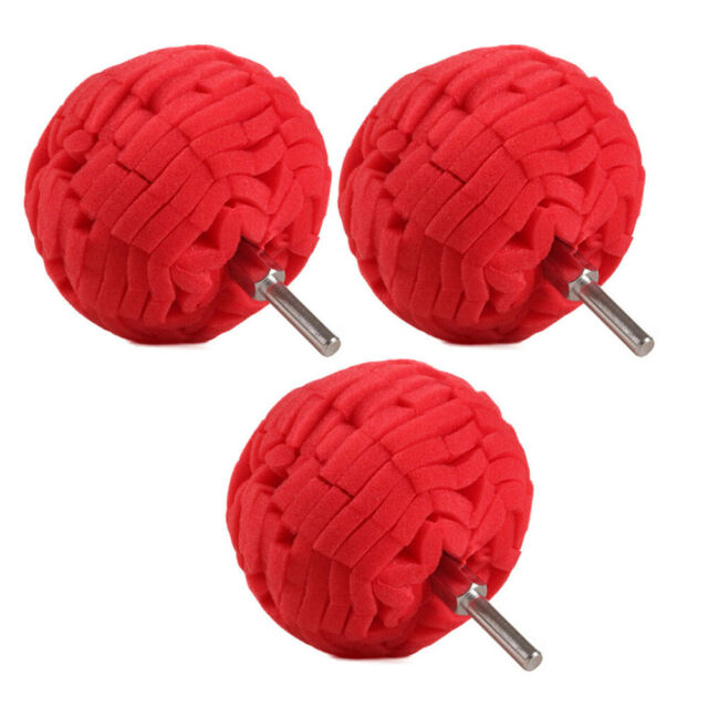

    I just did this yesterday on my daughter's Pontiac Vibe (Toyota Matrix). The headlights were extremely foggy. I started with rubbing compound to remove the oxidized plastic since it was extreme. Then moved up to the Mother's Aluminum Polish recommended by @ASRDogman using a sponge ball on a drill.
    The results were nothing short of amazing.
    I finished them off with a few coats of carnauba wax in an effort to offer some UV protection -- I don't know if that will help... but I figure it can't hurt.

    You could have just used the Mother's. I used glass cleaner to clean them of any dirt or grim.
    But as long as it works! (y)
    I was going to get one of those Mother's polishing balls, but $15-20?
    I paid $4 for the buffer I used. :) I'm cheap with some things....
    Though I imagine the ball did a better and easier job.
    I'll look for a sale, and then probably get one.
    Using the carnauba wax is probably a good idea. I'll have to do that next time.

    I tried just the Mother's polishing compound first, and it worked very well on the cloudyness, but the left headlight had some major oxidation that it just wouldn't touch... so I had to move up a step to rubbing compound. I'm not an expert, but what I do know is that working with finishes has to be done in steps: Wet sanding removes the most material, then rubbing compound is the next step, and polishing is the final step.
