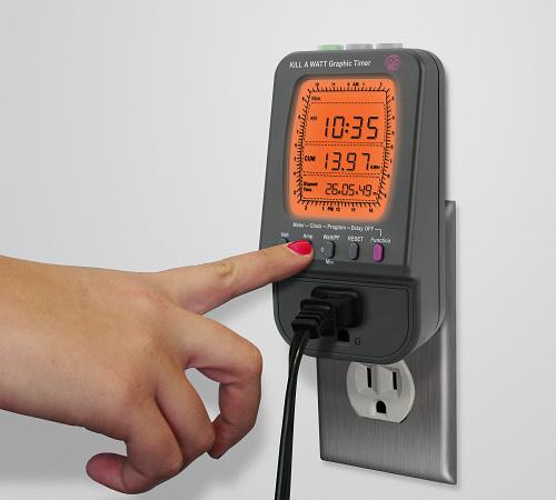

    I do not recommend the use of either Kill-A-Watt product with an EVSE. We have had many cases of them melting over in the Leaf forum. They are not built well enough to withstand 12a of constant load. I'd recommend something more robust, such as a TED or even a used utility meter (ugly, but accurate and safe).

    This post concerned me, since I am using a Kill-a-Watt with my L1 EVSE/Prius Plug-in. So I investigated this a bit more.
    According to Nissan's website:
    This means that Leaf owners should not be using a 15A rated Kill-a-Watt b/c the Leaf requires a 20A rating. They are using a Kill-a-Watt outside of specification, so melting is quite understandable.
    A Prius Plug-in only requires a 15A circuit, so the Kill-a-Watt would be working within specification.
    Unless someone actually experiences a Kill-a-Watt melting while properly charging a Prius Plug-in, I think pEEF's warning is unwarranted.

    While it is true that Nissan recommends a 20A 120V dedicated outlet, the LEAF does not actually draw more than the 12A maximum of the PiP so any concerns about the Kill-A-Watt would be equally valid.
    However.... The PiP only draws that 12A for about 2.5 hours whereas the LEAF could be drawing power for 21 hours. Heat can build up so it's possible that a longer charge on a LEAF might have some additional chance of heat-related problems simply due to that difference.

    At $20 on Amazon and free shipping, the P4400 is rated at 15amp and my PIP charges are only 11.6 - 11.8 amps. And Amazon is trustworthy.
    In fact I bought 2 more, that I'm using to test my old Beer frig and a spare freezer before I replace them with EnergyStar units. I'll then use one of them at work.
    To avoid plugging the EVSE in and out of the Kill A Watt every charge, I bought a 4' 12/3 right-angle cord to plug into the Kill A Watt and plug the EVSE into it.

    The Specs list 125 vac Volt Max and 15 amps Max.
    So it's ok for the PIP that only draws 11.7 amps.
    But it's more than you need.
    The P4400 is $20 on Amazon.
