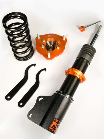

    6061 billet aluminum the kit is lightweight, durable, and rust resistant. The steel shock body is electroplated with zinc to resist rust and the elements. $1,235.00 for 4 at andy's autosport.

    a Bit more than the $350 i paid....
    Pretty....but until i've wore these out or see the need to spend that much dough, these are fine. :)
