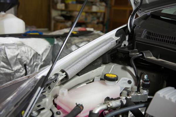

    Harold, if you're using foam tubing for grill block, you can also put a couple of pieces along the crimped edge at the hood seam beside the front fender zones. Here's an old pic, I've redone with tubes a bit longer. We had a rat take up residence under the hood for a while; he chewed the heck out of the (pictured) tubing. He's gone, we managed to chase him out of the garage one night, but his legacy lives on. Was doing an oil change yesterday, took off the undercover, and found remnants of some forgotten scented candle, half chewed away, on top of the undercover, lol. I took to calling him "Ratty".
    Sorry, rambling, pic:

    Could you explain in more details what's the use of that piece of foam tubing there? I thought that the grill was the front one in the bumper. Excuse me if this is a stupid question (and off topic).

    Grill block prevents excess cold air coming in through the front. The idea with the tubing (per the pic) is to better hold in the warm air already in the engine bay. At the back and front of the hood there's gaskets, but the sides are more open.

    I found hood side gaskets from Japan on eBay. I understand they are OEM over there. Why we don't get all the same features is puzzling :(

    Got it now. Thanks! No need for that here in South Florida ;)
