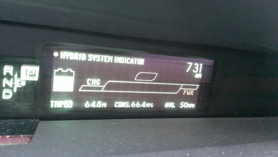

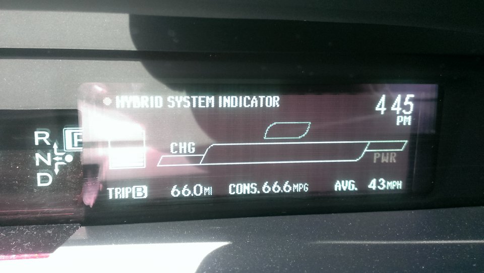

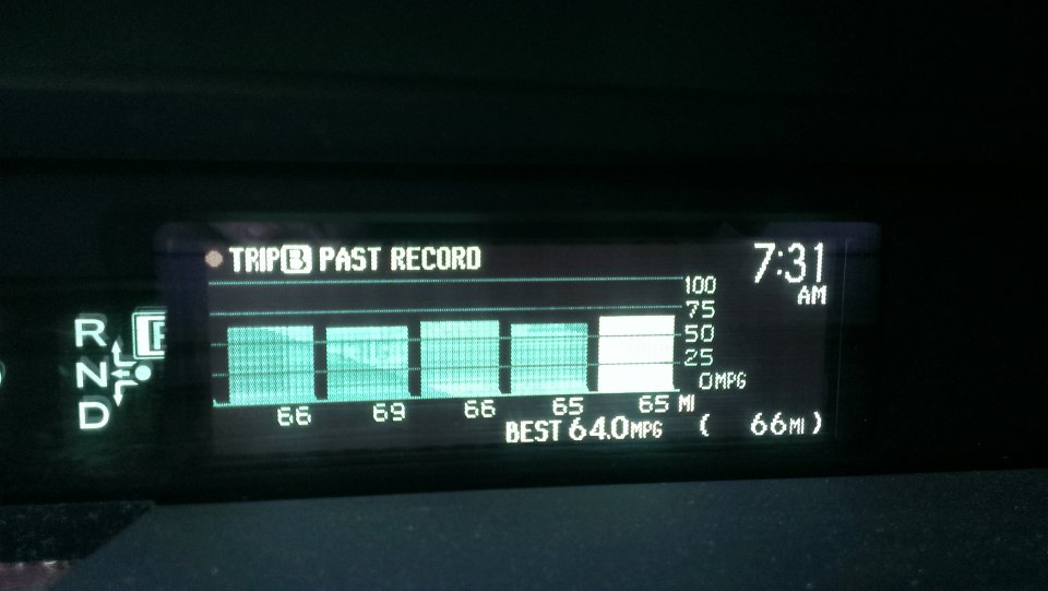

    I had mine done 2 days ago, and so far everything seems the same - I got 61 mpg the rest of the day (starting from a warm engine, with 4 trips totaling about 100 miles between 1:30 and 8 PM), which is possibly better than I might have expected previously, but not impossible. Also did some mountain driving yesterday that netted about 52 mpg. Of course, that's just what the computer reports, so it'll take a few tanks to be sure, and to get more of our usual driving routes in.
    Nothing behavior-wise (acceleration, engine on/off, etc.) seems different either, at least so far. I do drive somewhat conservatively though, so YMMV (literally).
