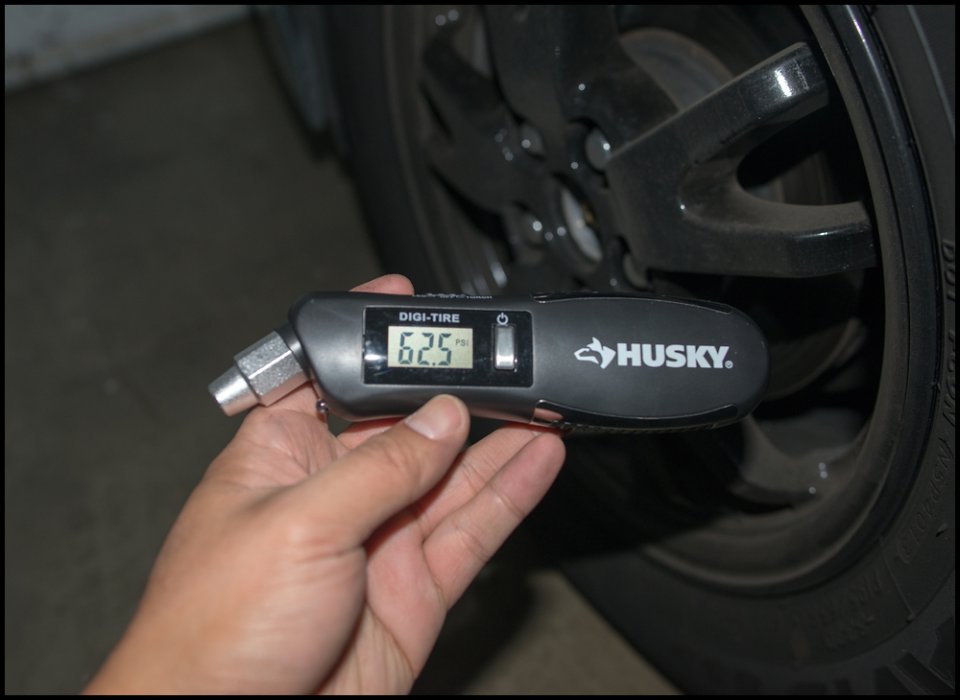

    It's not a typo. Just got my Prius in November and it came like that from the dealer. I have no idea why they put too much pressure in the front tires, but now that they are adjusted to the "normal range", my MPG definitely took a hit.

  10. Mendel Leisk
    61,574
    42,364
    When cars are shipped from factory they sometimes have tires all raised to sidewall pressure. And dealership might have missed the fronts. But even sidewall posted pressure is much lower. Yeah, way too high.
