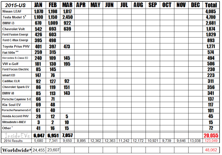

  7. hill
    21,207
    8,800
    I don't want to be a spoiler for our regular sales update, but according to the chart the i3 outsells the Volt - month after month - even though the BMW is more expensive. I suppose the only redeeming / saving grace for the Volt is, not all of those bmw sales consist of the pure ev or the hybrid version.
  8. Trollbait
    23,438
    12,520
    The Volt sales are suffering from people waiting for the next generation. The i3 is new. In 2014, the i3 sales didn't get close to the Volts.

  10. austingreen
    austingreen Senior Member
    Nov 3, 2009
    13,671
    4,209
    Austin, TX, USA
    March 2015 Plug-In Electric Vehicle Sales Report Card | Inside EVs
    Bottom line is people are waiting for the improved gen II volt, and Gm seems to want them to wait. The Gen II volt looks to be both a better ev and a better hybrid. It won't be as good of an ev as the i3, since its heavier and less efficient with a smaller battery. To get these things the i3 added carbon fiber which for the time being adds cost. The gen II volt looks like it will be a better hybrid than the gen I, being lighter with a more power full and efficient engine as well as allowing parrellel serial hybrid modes at all speeds. In the US I expect the gen II volt to greatly outsell the i3, in europe though the i3 won't even have the volt as competition.
