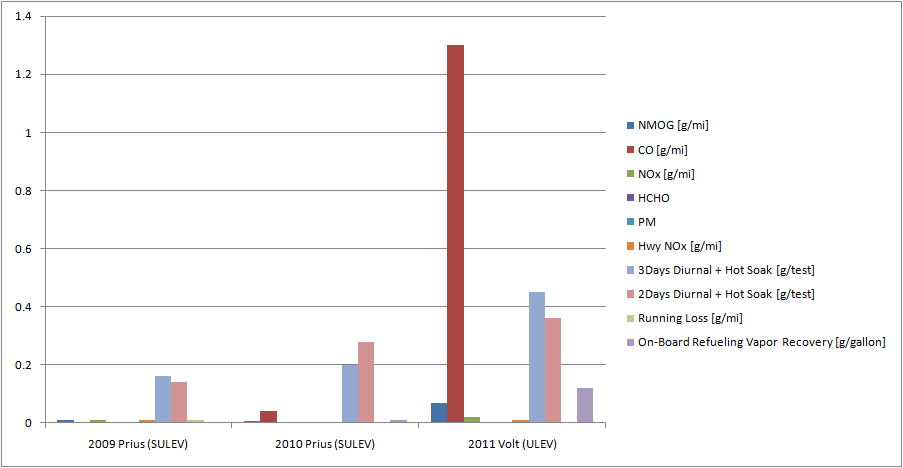

    Ok, so I went to the fueleconomy.gov site to look at total GHG emissions for my state CA of PiP vs. Volt. The site tells me tailpipe + upstream CO2 for
    2015 Prius Plugin = 220 g/mi US natl. avg
    2015 Volt = 250 g/mi US natl. avg.
    average new car purchased = 480 g/mi
    another chart showed 'emissions' as 6/10 then 8/10 for Volt (one was bin 4 something or other, the other ULEV rating, see for urself)
    and 9/10 emissions for PiP. I don't like that 6/10 figure for Volt. Didn't see why that is.
    Does the Volt put out more of other types of emissions besides C02 than PiP?
    Interestingly, regular Prius 2015 clocks in at 218 g/mi CO2 natl avg, less than the PiP.
    CA avg CO2 for PiP and Volt was 200 g/mi
    Overall Volt looks like a very clean car emissions wise and it can sure use very, very little gasoline for some folks.

    The volt is getting tested on newer stricter standards, it gets 9/10 for the pzev standard like the prius. Of course the ice is off for a high percentage of those miles, so lower per mile on some maybe higher on others. Both the gen II volt and gen IV prius come out this year. I expect both will be lower on the new tests.
    its likely I haven't looked at the tests. The volt doesn't use canisters so evaporative emissions are likely higher, canisters don't work well if it may be weeks before you turn on the engine again. Overall both cars are extremely clean. They are in the same bin in the pzev standard so differences will be small.
    +1
