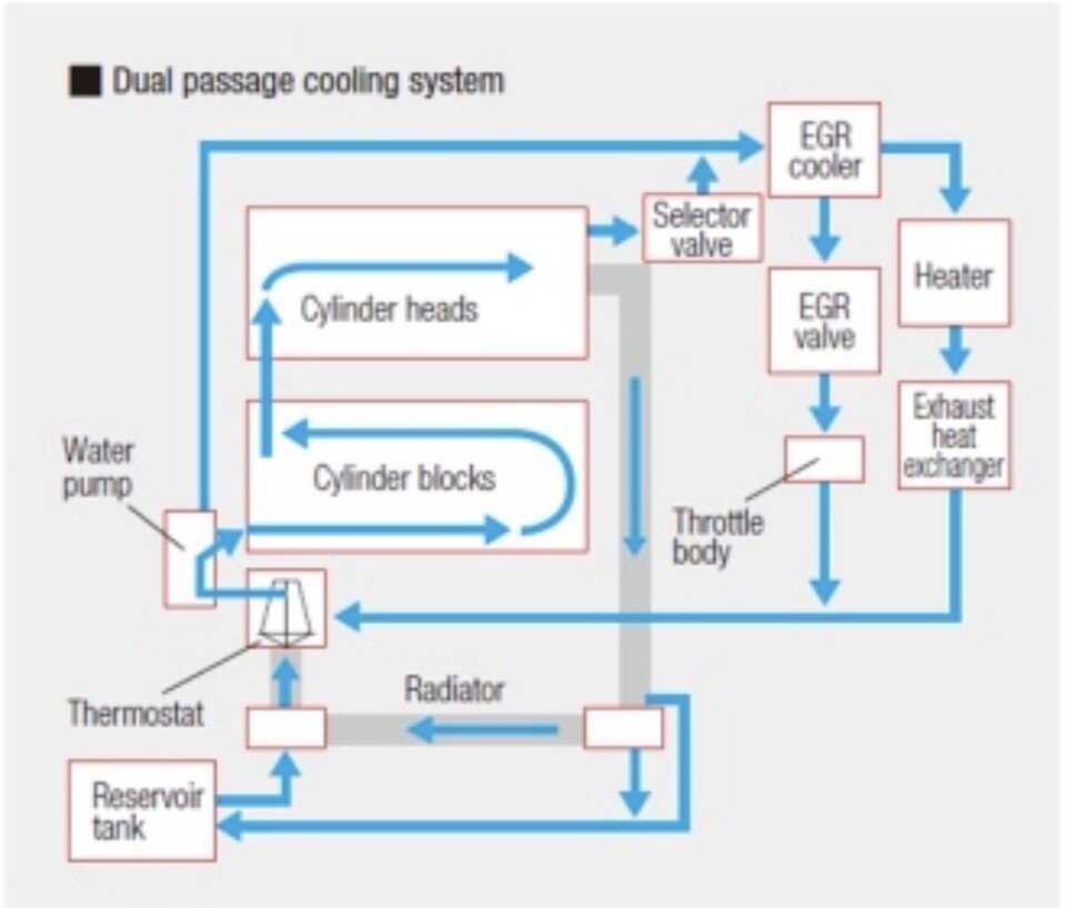

    One of several cooling system changes on gen4 engines was an egr valve with coolant passages.
    Other changes included grill shutters, cylinder wall insulators, a coolant flow selector (shutdown) valve and improved head gasket, block and intake geometry. The egr gasses were taken after the cat rather than before and the egr cooler was larger.

    I think I remember noticing coolant nipples added to the Prius c EGR valve also.
    While it suggests Toyota decided at some point they'd like to keep the valve a bit cooler, I would be very surprised if the passages offer any way at all for coolant to get near the moving parts. My bet would be it just flows in passages of its own through the aluminum body of the valve.
