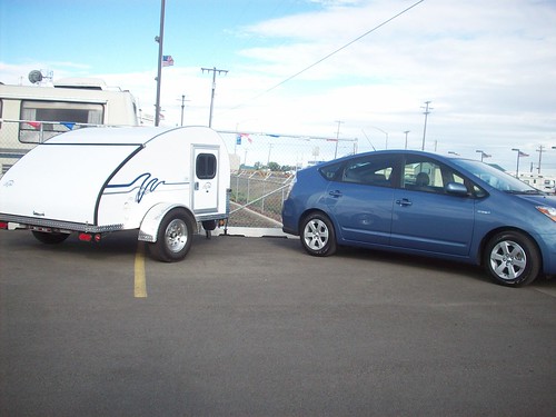

    Here is the trailer that I'm thinking of getting. I talked with the dealer, and they say that the actual weight is 850 pounds... So then, after my work on it , it'll be just over 1100 pounds. WOOHOO!!! Now to earn some money...
    The Steaks
  11. AzizaVFR

    Acutual weight will be around 1000 pounds. See my last post to see exactly what I'll be pulling. Any other thoughts or comments?
    The Steaks
