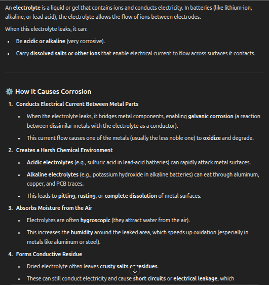

    So I just asked Google AI and then Asked ChatGPT this question and as usual GPT one was better (enclosed below):
    Specific to Prius packs there lots of different humidity-based and electrochemical and akaline processes involved that lead to this corrosion from trace amounts of NiMH electrolyte leaking from the seals of the modules. No doubt severe changes in temperatures play a roll in these very tiny leaks that Toyota can't prevent in a cost effective way. But your original voltage sensor wires act a means for the corrosive process to reach the pins of the ECU and you can get a new higher quality voltage harness at a 10% discount if you use this link: http://www.acenbay.com/?ref=priuscamper
    If the corrosion on the pins inside the ECU goes on for too long you'll start getting micro-arcs between that first pin and one next to it and you'll see it first as a sudden voltage drop down to one or two bars on your charge screen even though pack hasn't lost charge, it's just the ECU sensor getting scrambled. Once it progresses you'll get smoke and melting of the voltage sensor plug at the ECU which usually destroys the ECU.
    Anyways, here's a taste of how this corrosion happens according to chat GPT:
    ChatGPT - Electrolyte corrosion process

    What was the prompt you used to get that ChatGPT response? Did you hint that you wanted electrolyte leakage to be part of the answer?
    I've seen malachite dependably grow on copper terminals given just exposure to humid/road environment and constantly-applied voltage.
    A lot less of it in modern cars because the sealed, weatherproof connectors used under the hood have become much, much better.
    The orange connector in the battery isn't that sealed kind though.

    Had you clicked the link/reference you would of seen the question asked was: "How does electrolye cause corrosion when it leaks?"

    As I generally browse with JavaScript disabled, clicking the link shows me an approximately blank page. But thanks for clearing up what the prompt was.
    I'm largely in favor of including the prompt up front whenever citing an AI result; it's always useful to know what result the AI was asked to produce.
