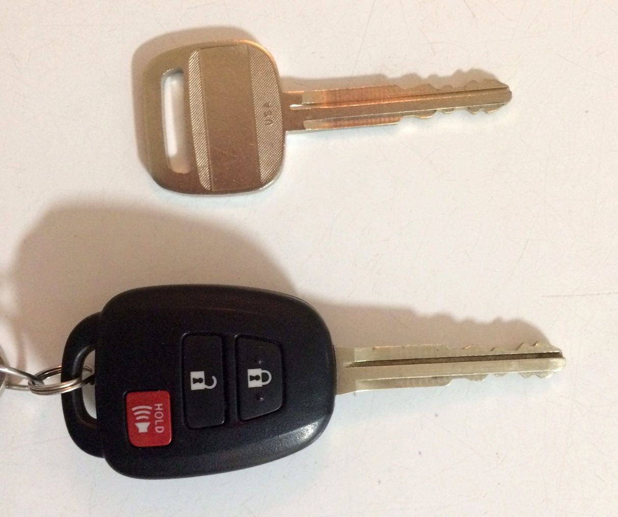

    As a single woman, I wanted my friend to have a spare key to my car, in case I got locked out. Toyota *and* an independent locksmith wanted $200+ for the key plus programming.
    I got to thinking, I'm mainly worried about locking myself out, so I had a cheap key made at a local hardware store. It could open the doors, at any rate.
    Lo and behold, it starts the car up just fine.
    I thought these keys had chips in the head, as an anti-theft device.
    Can anyone offer some insight? And is this "spare" going to leave me stranded?
    Thanks for any explanations.

    I think it depends on if the car came with an immobilizer or not. Mine is the "L" trim, so it doesn't have a push-button start, and the remote is similar to yours, but without that red button.
    When I got my Aqua (second-hand, auctioned from Japan), it came with just the one key. So, I went to the local keysmith to have a copy made. I wanted to at least have a key that'll let me unlock the car should I lock the keys inside. But hey, lo and behold, the basic key would not only unlock the car, but would also start it.
    I then did get another remote key made. The guy had to physically plug in a console to the car (from the inside), and register the key using it, so there is that.
    I am still going to get a physical lock for the car though.
    By the way, please black out the "teeth" of the keys in the pictures. I have heard of people using images to 3D print copies of keys.

    I should have specified, the original TWO keys were placed in a faraday cage before attempting to use the new cheap key to start the car, so there is NO radio signal being transmitted. (I'm also an "extra" in amateur radio.)
    So - this has nothing to do with proximity to the original key fobs.

    As to the 3D thing - those keys are in the shadows AND if someone wants to use those keys to make a 3D image and then come find me and steal my slightly used Prius C, I'd make national news! I'd go viral!
    Woo-hoo!

    It does have to do with the trim level of your car.......and the fact that it does NOT have electronic theft protection on the ignition.
    Your test pretty much proves that.

    Prius C One has no immobilizer. Any key with the correct bitting will start it.

    the 2013 and 2012 c1 is just a simple key, no transponder

    If you have the lever one, you dont have anti-theft.. to check, when it is dark, look at the lower part of your dash/console..do you see a blinking red light? No light=no anti-theft system.

    I just had metal keys cut for my Daughter's 2015 Prius C One using the valet key. Lowes checked and it did not have a chip. I tested it and it started the car. I have not done a test drive yet.
  20. bisco
    115,446
    52,855
    well done! (y) if it starts, it drives
