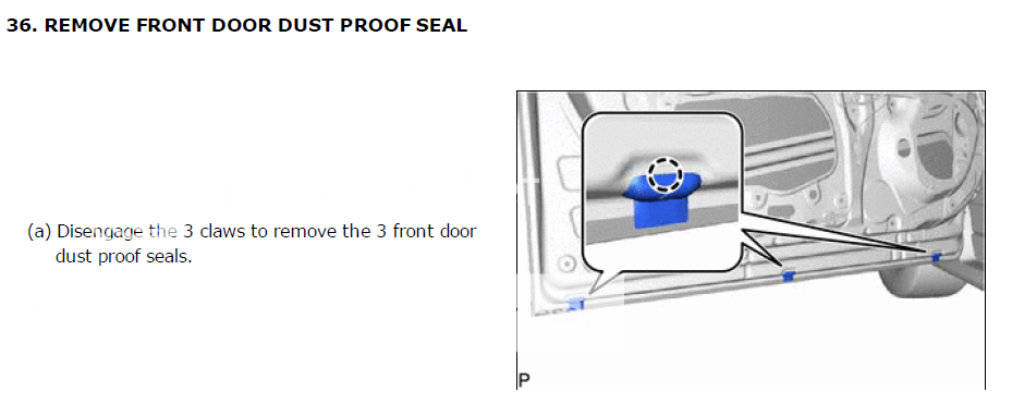

    They're called "Dust Proof Seals". So evidently not drain plugs, but to keep the dust and debris out. Not sure why the holes would be there in the first place though.

    Is there a drainage hole in that plastic piece? There should be, if they're not just some sort of temporary shipping piece, meant to be removed before sale.

    Where did the image come from, and is that from the pre-delivery inspection procedure or the door panel removal procedure? i.e., are they supposed to be there?

    It's from Toyota "Technical information system" https://techinfo.toyota.com/techInfoPortal/appmanager/t3/ti?_nfpb=true&_pageLabel=ti_home_page&SMENC=ISO-8859-1&SMLOCALE=US-EN&SMAUTHREASON=0&SMAGENTNAME=%24SM%24mT%252bGLraBu9CwUVnZg4mEDzB2kysT90hgbwsWgdZzNOc%253d&TARGET=%24SM%24https%3A%2F%2Ftechinfo.toyota.com%2F
    I was taking the door panel off to replace the speakers (and some other mods in other parts of the vehicle), so I bought access to it for two days ($15). They are supposed to be there. As mendel-leisk suggested, there is, indeed, an opening behind the plastic "flap" that lightly covers the opening--evidently to allow water to drip down while keeping the "dust" out.

    Thanks so much! Mystery solved!
