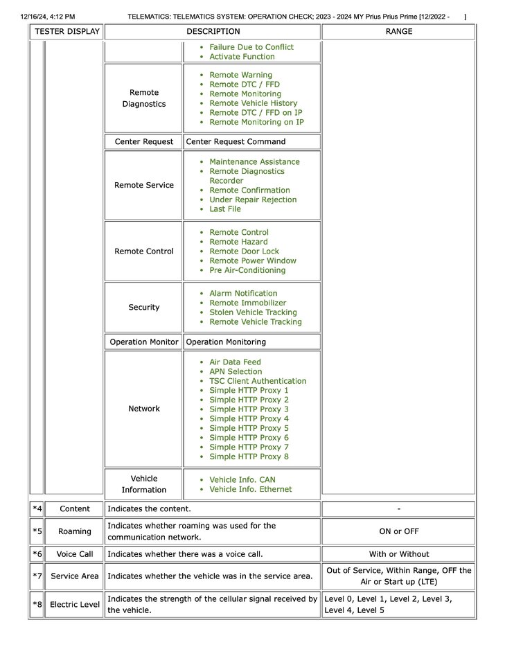

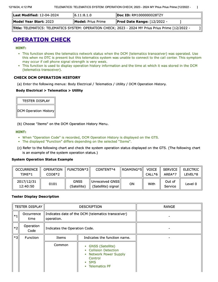

    Finally, I found a couple pages from the Service Manual indicating that their Techstream system does log things related to the Data Connect Module (DCM). You'll see in the "System Operation Status Example" that it'll log occurrence time, whether roaming was on or off, if the vehicle was in a service area or not and what the strength of the cellular signal received by the vehicle was. No doubt, they can pull a report to coincide with the blocks of time you know you've had problems within recent history.
