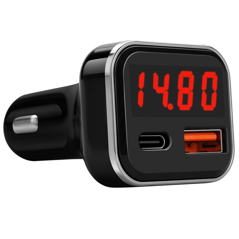

    I think you answered your own question. Since you moved to your new residence, your car seems to have difficulty connecting to the network to relay info and that is causing the 12v battery to drain.
    If you want to check the 12v status you can buy these car adapters with USB 12v meter.
    AI response to disable Toyota connect feature:
    I'm using Jack's Sodium Ion 12v battery and his app can show exactly how much amp is being drained even when the car is off. This is after the car has been sitting for one week without use on this 12v pack.

    I have been using such a socket voltmeter since day one.
    I can only assume that disconnecting parts of the system causes the same slew of problems I experienced when the battery had gone completely dead. It took me a week to get things back to normal. I am hesitant to risk the same thing again.
    I will be quite happy to park my car where I can use the battery maintainer, once my other car is out of the shop.
