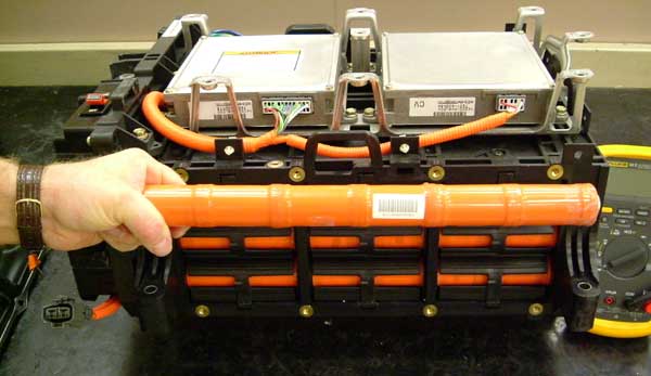

    Bob,
    Again, I intend to replace my Insight traction pack. The cheapest way is the time-consuming pull batteries out and refurbish as many as possible - replace the heat-damaged ones. Some aftermarket packs are under $2K, have 25% more power than the Honda OEM pack, AND run cooler (important in the Sunbelt)
    I'm open to suggestions
  7. bwilson4web
    28,675
    16,217
    Sorry, you are not qualified to be a troll. <grins>
    I don't know enough about the Insight traction battery characteristics to have an opinion. The key would be using welded tab cells that were pre-balanced but I don't know if the battery management system has any other sensors on the batteries. For example, the NHW10 used D-cell tubes and has a 3d sensor electrode in each string.
