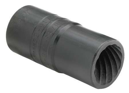

    One of the engineers came by and told me about 'lug nut remover sockets' and I looked them up that night:
    A hardened socket, they have internal flutes that 'dig into' the nut with no requirement for the six-sided faces. In effect it forges a grip on the nut, rendering it a useless but removed former lug nut. At least the wheel can be removed.

    Using the lug nut removal sockets and 2 lb sledge, Josh hammered them on and with the extension and break-over, got the top one out. Using the same experimental technique on the other lug nut, he got it to come off too!

    4. Use the lug nut removal socket(s) and the 2 lb sledge to pound the removal socket onto the damaged nut. Do not be shy or gentle.
