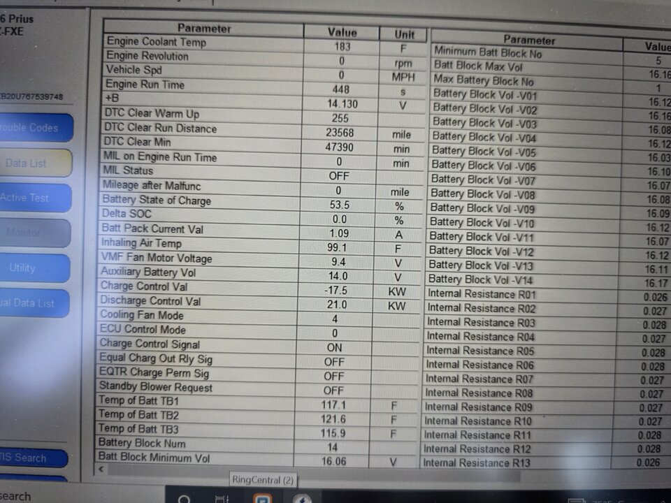

    I know it's a very old thread, but the original post has a point about the ECU not being able to control the fan properly, and I'll tell you why:
    My 2006 got to 132f recently, with the fan completely off ( i know how it sounds, i cleaned it multiple tilmes, and i put my ear on the vent, it was silent!)
    I opened techstream, and founf that the ECU is trying to put the fan and mode 5.
    I clicked the " active test" and was able to turn the fan properly to all the speeds 1-6
    But when switching out of "active test" the fan immediately turned off even tough the battery was hot over 125f, and the ECU was trying to set it to mode 4 per the " data list" table.
    So... there is something about the Auto mode that does not work, but it works in manual mode, which i believe that dr prius is using.
    I have to say that sometimes i do hear low speed in auto mode, but its definitely not as gigh as it should be per the techsream mode.
    So could it be the PWM signal to the fan that is disturbed by the cable corosion known issue?
    If so, its strange that this PWM is working fine in " active test" mode, and via Dr prius.
    Any advice is welcome, im an electical engineer , i like to dig into these things, but i dont have much time, was hoping someone experienced the same thing and has a quick fix.
    Thx
    Amitt

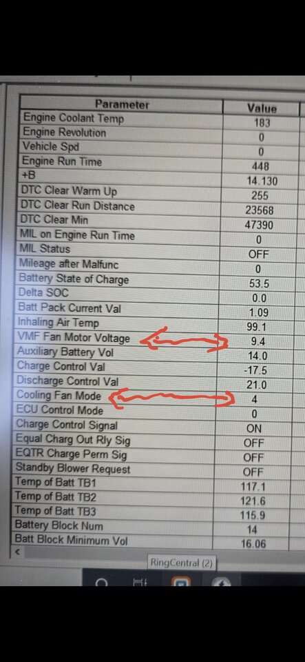

  20. amitt
    amitt Junior Member
    Aug 25, 2013
    53
    2002 Prius
    I
    Correct, i looked and pinout, the PWM and SI go through the same pins.
    Indeed weird, which makes me think it may be an ECU FW issue, where the PWM in auto mode is distorted by other signals, whereas in manual mode, it looks cleaner since some other features are disabled.
    The only way to find out is to put an Oscope there and see how the PWM looks in both modes.
    I attached the data table, you can see the return voltage which is supposed to be the feedback to the ECU that the fan is actually spinning at right speed.
    Per chatgpt, this is a problem with gen 2, because this feedback is not used to pop a fault, its just for diagnostic purposes. In any case the feedback is definitely wrong in manual vs auto mode.
    Im not sure if I'll have time or energy to scope the pins, i wonder how many gen 2 batteried were blown out if it is indeed a FW issue with the PWM once the wires become compromised.
    Any though will be appriciated
