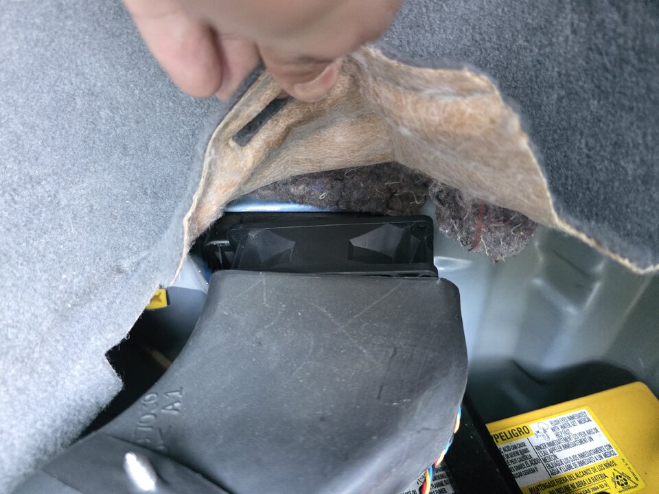

    When that white plug in the back rear right quarter get corroded the fan certainly does not work as expected and when they're corroded and broken it doesn't come on at all . It forces you back there to fix it jumper it something I now in the four twos here the fans seem to work as expected . I'm in the 100 not blowing batteries . We also not hard on car I other cars to beat on.

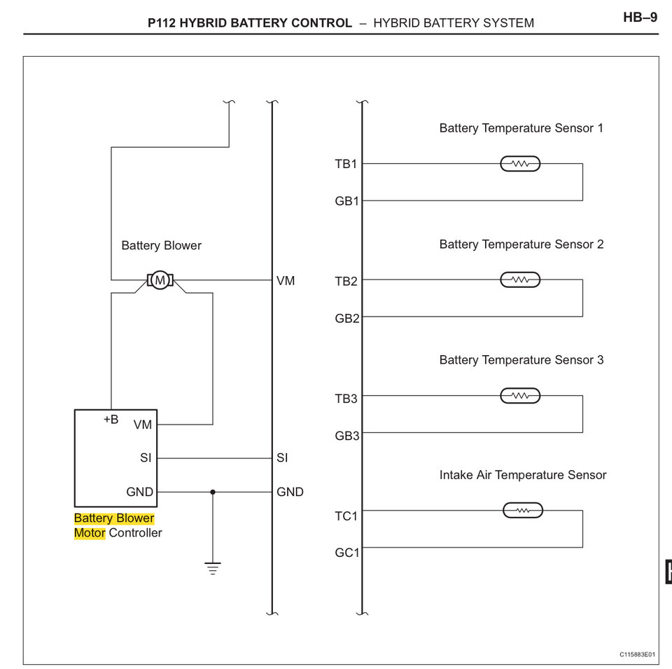

    @amitt are you getting any codes?

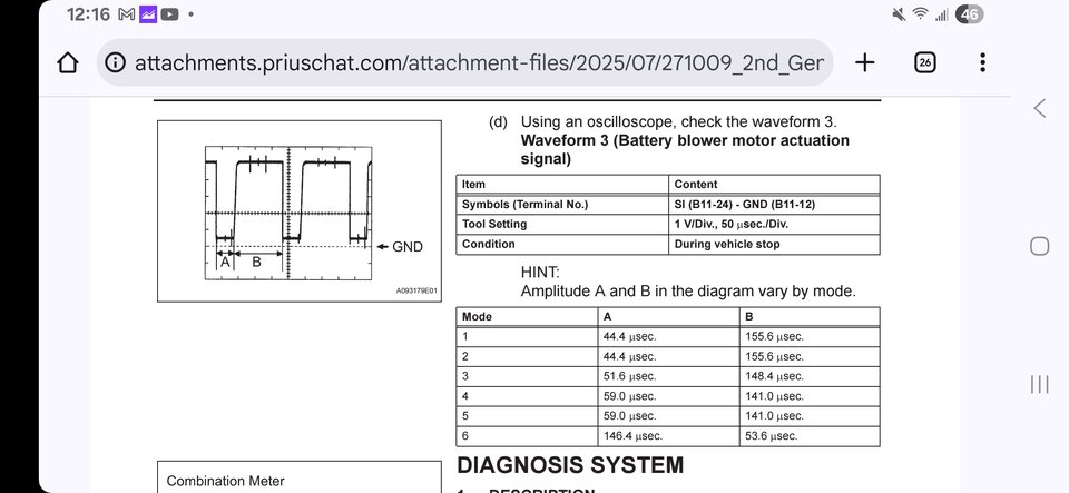

    Repair Manual excerpt attached:

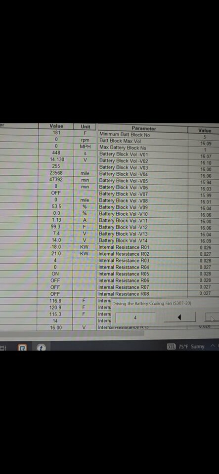

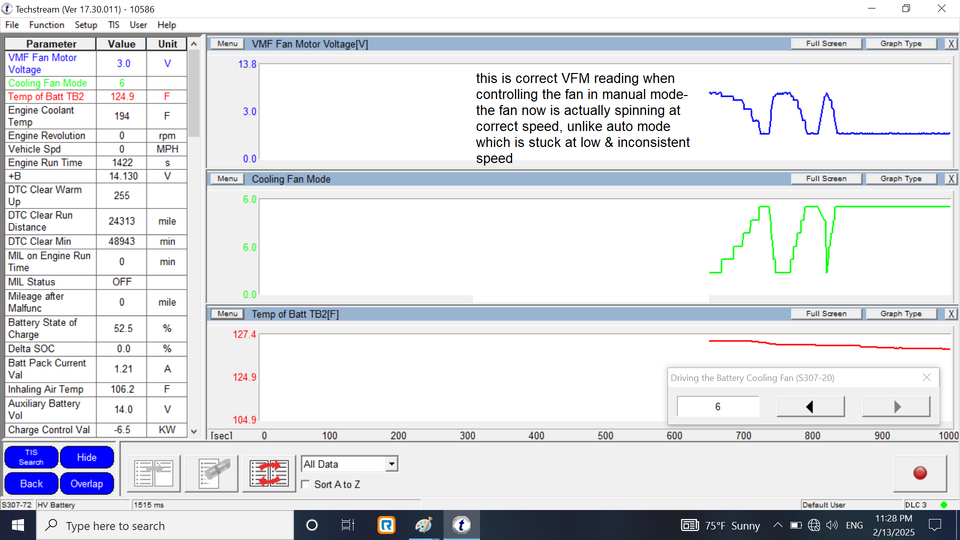

    No codes, i was just actively monitoring temps on dr prius on a hot day. I had suspected this fan for a couple of years now, tried to clean twice, and put some oil on the splinder of the motor.
    But when i saw the texhstream mode 4/5 attempt with no fan response, i knew that something is wrong with that auto mode PWM.
    Tombukt, that symprom will happen only in auto mode , but work fine in manual active test mode or via dr prius?

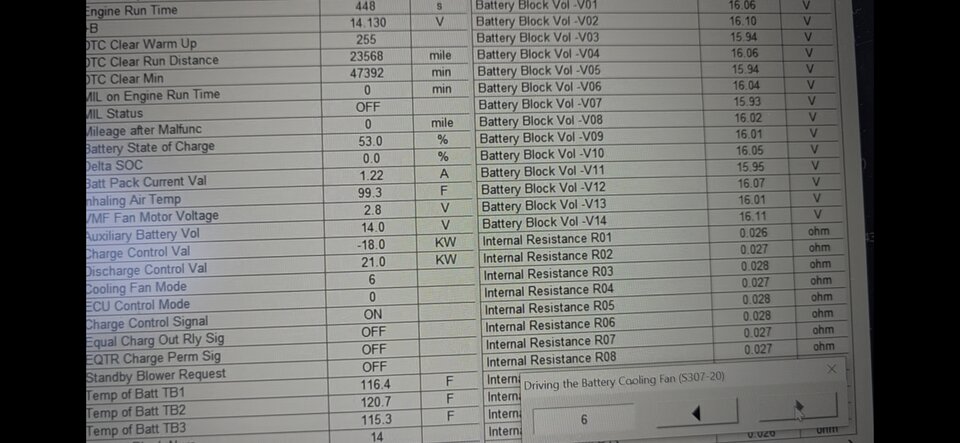

    Both screenshots you attached there are showing VMF = 9.4 V for control mode 4. Is that the VMF value you're saying is wrong, or the one you'd consider right?

    Correct, 9.4v is not a good feedback for speed #4 , how do i know besides trusting my ear that speed #4 was not on?
    Well... look at the attched screenshot i took with " active test mode" video, at speed 4, the voltage should be much below 7.4v , ( just toggled through the speeds fast without letting the feedback settle) at speed 6, the voltage goes down to ~ 2.5v
    BTW Mendel, thx for the pdf, i found the needed page regarding PWM signal ( attached) it appears that when the signal down time increase, the fan blows faster. This mean that if there is noise there ( signal high) the fan will not blow properly because the duty cycle will be too short, or it will not blow at all.

    I think amitt has reported seeing substantially different VMF readings when selecting fan speed 4 manually compared to when fan speed 4 is automatically selected. That's a puzzling finding in itself. I certainly don't have any story for it. Maybe we'll know more when amitt gets back out there with a 'scope.

    Agreed. Which makes it even more puzzling to see different values for the same targeted speed.

    I beg to differ, my assumptions hinge mostly on the ECU reported fan mode that it is trying to set , i can clearly see in on techstream as in my previous image, and the fact that the fan is either not turning at that speed, or not turning at all -is the issue.
    This is a clear indication that the ECU 'admits' that it detected a high enough temp for speed 4 , for instance as in the pic, but based on both my hearing, and the feedback voltage, it is 100% not turning at that speed.
    In one of my early images you can see auto mode, fan mode 4 ( as determined bu ECU) and temp of about 120f. This was an already reduced temp after i screwed aroung with the fan speed after it reached 135f while driving in auto mode, with absolutely no sound from the fan, as i put my ear right at the duct.
    Following that, when i set the speed to 4 via active test on techstream, the fan starts to work fine and is very loud at speed 4, plus, the feedback voltage goes down as it should, and temp finally goes down.
    Switching back out of active test either turns the fan off, or turns it on at much lower speed than 4, even though the ECU is still trying to set it to mode 4 per techstream.
    So... i dont think it can be any more clear than that ,after driving a few days in hot weather and crazy santa cruze downhill regen charging, dr prius is able to keep the battery cool , which meams the fan is fine, the system that controls it isnt. I am suspecting the PWM signal and some noise that does not allow the low duty cycle to reach minimum pulse width...

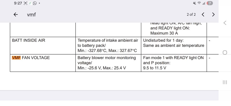

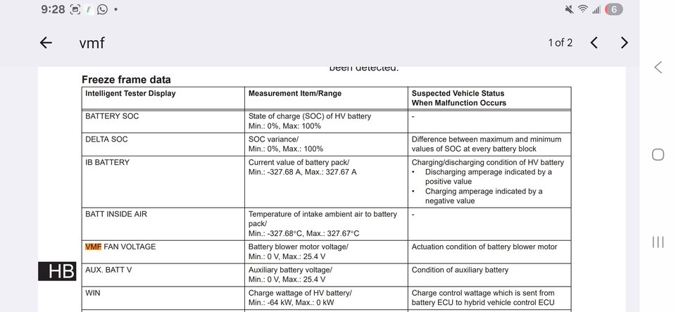

    Chapman, I'm with you on chatGPT, however, from the pdf that Mendel kindly provided, the VFM is only mentioned twice,just some basic voltage range , and voltage at speed # 1, which is very similar to the voltage i was getting when my ECU ordered it to go to speed 4 and it was about speed 0 , or 1, which match this documentation perfectly.
    Perhaps there is monitoring of this Voltage , but it is not clear how well it is done, and how to validate the threshold or delta from target.

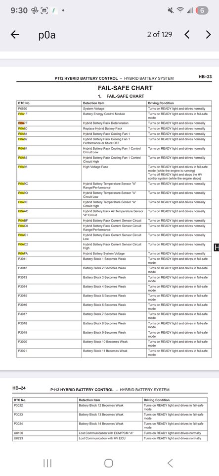

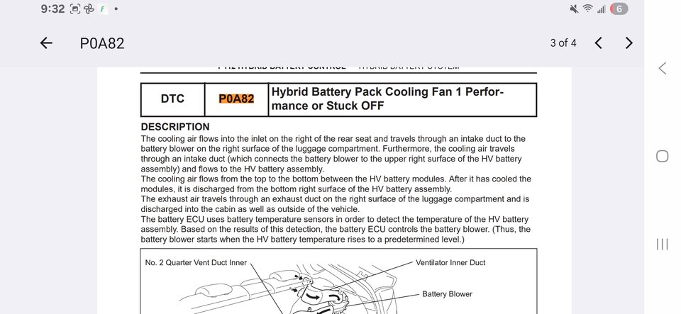

    Even though VFM is not mentioned with any DTC, P0A82 or P0A81 may suggest the usage of some voltage , even though VFM is not specifically mentioned, and no clear guidelines of target voltage range for each speed is specified.

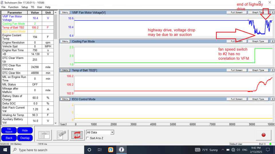

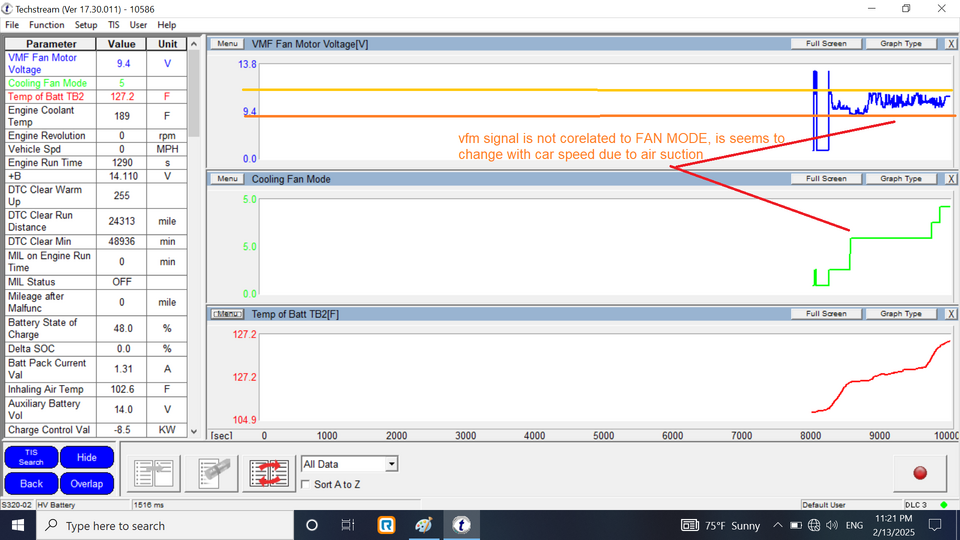

    Hi Guys, I have some interesting measurements:
    I got 2 screenshots from short drives I made, and 1 from manual test.
    observations::
    1) my car can only turn on the fan at very low and inconsistent speed, or it is stuck off- today during those measurements the fan was on at low speed, without it it can easily go to 135f with no error codes.
    2) from the first drive, based on the VFM ( if you can even trust this signal)you can see that the fan speed is not consistent and not corelated to the ECU control setting, not at mode 1, and not at mode 2. if anything , the VFM drop may be corelated to car speed on highway due to air suction.
    3) from the second drive, you can see that the VFM is just rubbish, even though the battery got so hot that the ECU ordered the fan to go gradually from 1 to 5, the fan was very quiet, and definitely did not spin at speed 5.
    If we can trust this VFM signal, we can see it was fluctuating and very unstable around 9.4V, this shows that the PWM signal cannot be parsed accurately, it seems to be more dependent on noise and interruption of the "low" duty cycle, than related to any of the ECU ordered speeds 1-5
    4) in manual mode, the fan speed and VFM correlate beautifully, and it also corelate perfectly with my ears. trust me, at speed 3-5 the fan is very loud and it is never that loud in auto mode.

    I've now seen evidence that your car exhibits wacky VMF readings that don't seem to correlate to the automatically-selected control mode.
    Your assumptions about why that happens, with automatically-selected control mode, but not with manually-selected control mode, are not crazy assumptions, but neither are they proven. Oscilloscope traces of the PWM signal in both conditions would provide evidence to prove or refine those.
