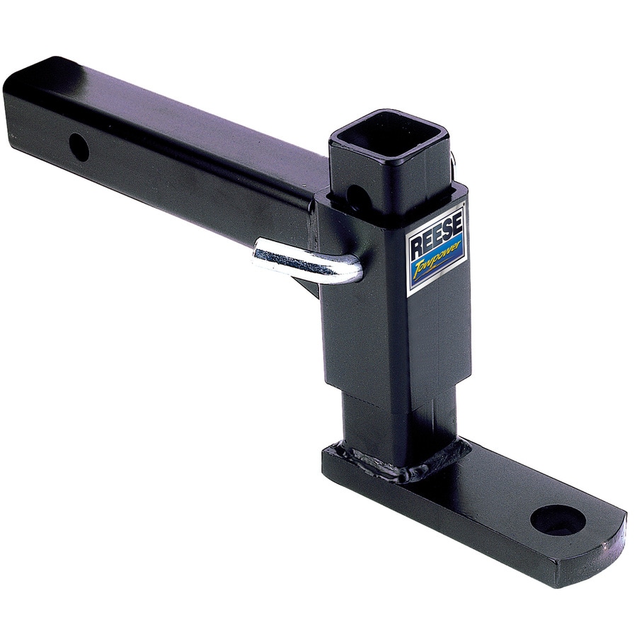

    The side view shows the low clearance with the receiver. There are inches to spare opening the hatch so I don't have to pull the quick-release pin to access the rear. I may experiment with some sort of strap to help raise the assembly as it appears to droop.
    The back-up sensors complain but you can see around the chair. Raised a few inches, I still expect the warnings but better view under the rack. Once you go over 6-8 mph, the alarms turn off.
    The rear view mirror view is not obstructed but will have to check again after getting a taller receiver.
    The blue knob on the top adjusts an arm that holds the chair firmly in the rack. The small blue knob on the lower right is the quick release that tilts the rack so the big wheels touch the ground. Very easy to load or unload.
    This is what it looks like walking up to the car.
    I don't like this receiver (sold separately) because the chair rack is too low. When pulling out of the driveway, there is a gutter between the curb and driveway and it started to scrape. Driving at an angle worked but only because I knew it was there. In an unloaded car, it cleared the 'speed bumps' (i.e., sleeping policeman?) A few extra inches should do it.
    I also bought a 5/8" x 2 1/2" bolt and locking nut as the original was too long to fully seat. I also don't care for lock-washers versus a locking nut with plastic insert. A general hardware bolt, I may look for a higher quality bolt and of course, replace the locking nut.
    I was not trying to do handling or drag tests until I get the ground clearance right. When I took it off, keeping the receiver (the part that inserts) is the easiest way ... take wheel chair off first. <grins>

    This might work as a strap anchor point.
    Cable Anchor &#8211; Trunk | SeaSucker
    Does the wheelchair carrier bolt to the receiver or clamp onto the ball?
    Adjustable ones like the above will introduce more play for more accessory droop. There are twin pin types that will lessen that for higher price.
    I'd recommend figuring out how much higher you want the carrier, and get a fixed receiver with that rise. Curt has some that go up to 8 inches. Class 3 Ball Mounts | Standard-Duty | Curtmfg.com
    Depending on the hatch clearance, you can get a local metal shop to trim the receiver length so the carrier tucks in better to the rear.

    Turns out to be fairly simple:
    • Find insert for the vertical, square tube
    • Drill new hole(s) offset from vertical by 8 deg
    Reassemble so now the platform and vertical arm are 'normal' with respect to both horizontal and vertical. I have a drill press and bits for the holes are probably in my kit. Use lots of cutting oil, patience, and new bolts when done.

    On my wheelchair carrier, I decided to buy an 8 degree, wedge shim, which I'll drill a 5/8" hole. Then I was just at Fastnal and bought a package of wedge washer that measured ~9 degrees. This will let the BIG bolt ride normal to hold the assembly together. With a generous amount of blue Loctite and properly torqued (a Big UGH!), it should work.

    I had this problem of an 8 degree droop:
    Leaving the driveway, the rain gutter at the curb caused the rear of the carrier to scrape. No problem with local speed-bumps.
    I bought an 8 degree, wedge shim used by off-roaders who lift their suspension. A wedge shim handles the new body-to-spring-to-axle angle. After re-drilling the mount hole to 5/8", here it is installed:
    Notice the platform is now parallel within a degree or so of a line drawn axle-to-axle of the wheels.
    Here is the wedge shim in the assembly:
    The tow ball mount droops a little then you can see the small end of the steel wedge. On top of the wedge is an alignment part that comes with wheel chair carrier to keep it from rotating around the bolt and shifting to the rear. The wedge actually over-corrects a little but the 'slop in the system' lets the carrier droop to level.
    Now one potential problem is the bolt holding everything together has to deal with an 8 degree angle. Cocked at an angle, one side of the bolt-head would be have all of the stres and the other side, unloaded. Over time, road vibration would lead to a crack and the head separating ... not good. So I used a 9 degree, wedge washer:
    Annealed, the washer conforms so the bolt-head is evenly loaded. It also means stress will in effect keep the bolt-head from any rotation.

    Too bad that tongue wasn't a bit longer to put another bolt in it. Might also want to think about a safety cable and spare bolts. Safety cable to keep it from becoming an instant road hazard (which you might be liable for) while giving you a chance to repair it with a spare bolt. I mentioned a cable and not a chain.

    I am thinking one of those plastic covered, bike cables with a lock. That would prevent things from 'walking off' too.
