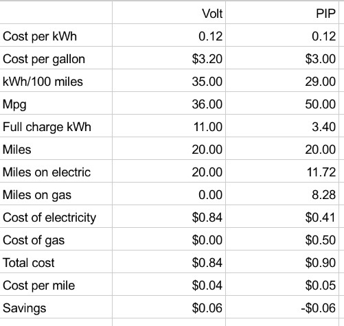

    To bring this back to relevancy for the OP, I added another sheet "Compare EV" that has the Volt vs. PIP at a 20 mile daily commute using my local electric and gas prices. The Volt saves 6 cents per day.

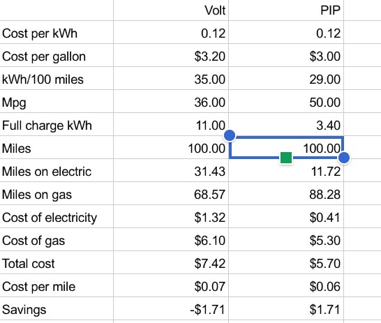

    Here is Volt vs. PIP fuel economy at 20 and 100 miles.

    Will the PiP accomplish 50 mpg from cold going 8.3 miles?
    I doubt it.
