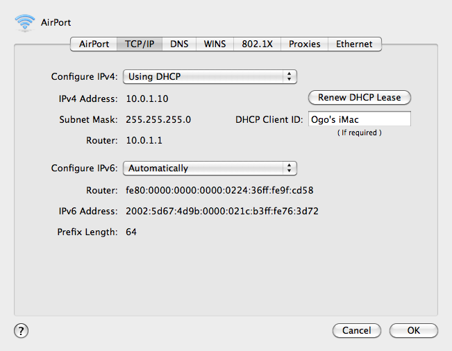

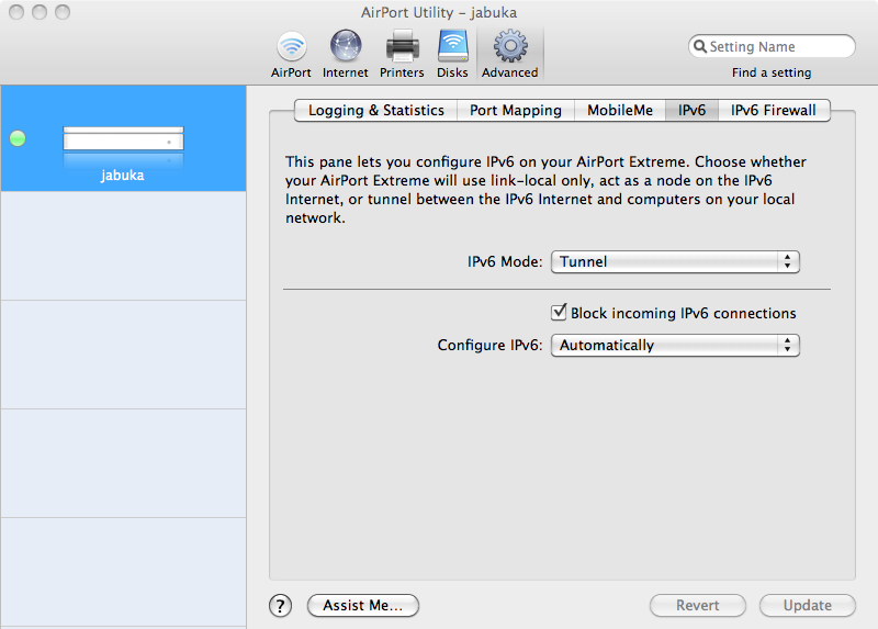

    As images say more than words.
    IPv6 settings for Airport Extreme:
    IPv6 Mode: Tunnel
    Block incoming IPv6 Connections: Checked
    Configure IPv6: Automatically
    On your Mac, go to System Preferences, Network, Advanced, TCP/IP:
    Configure IPv6: Automatically (default is Off)
    (If everything breaks apart, then use Link-local only for IPv6Mode on Airport Extreme and Configure IPv6 to Off on your Mac)
    Not all operators/providers support IPv6 yet, but those settings above are usually good enough for things to work when they will start supporting the new internet protocol.
