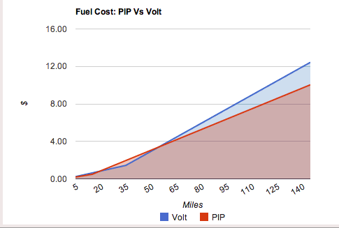

    Assumptions:
    Premium Fuel 3.7
    Regular Fuel 3.6
    Volt CS MPG 37, EV range 35 miles, 3 miles a kwh
    Prius CS MPG 49, EV range 15, 4 miles a kwh
    12 cents a kwh

    Yep, the graph shows Volt's advantage on trips between 15-35 miles, the 20-mile sweet spot that USB stated a couple of posts ago.

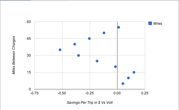

    Here is the same data as above, organized to show from a Volt owners viewpoint how much each trip costs more or less in fuel than the same trip in a PIP.
    Less than 15 miles or more than 50 miles: The PIP costs less per mile fuel. Between those numbers the Volt costs less in fuel/mile, with the best result at 35 miles where the Volt fuel was 52 cents less for the trip. So an IDEAL Volt owner saves about $15 a month in fuel costs vs the PIP. :rolleyes:
    Negative number: The trip in a PIP costs more
