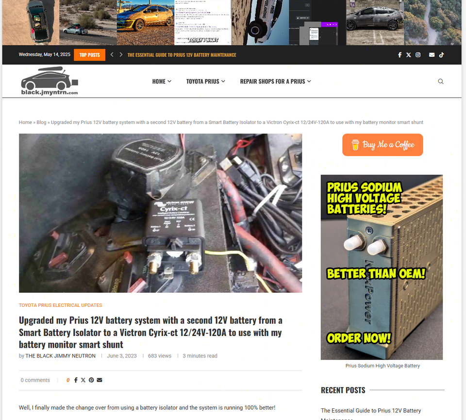

    i dont know bud... ive got 140ah in my gen 2 that doesnt take 8 hours to fully charge via the car in ready mode... are you sure? any data to back this up?
    have you any quirks? i went through three isolators and it wasn't until battery combiner did all function without hiccup.
    https://black.jmyntrn.com/2023/06/03/prius-dual-battery-upgrade-victron/
    i put a high powered relay back there on the negative line so I can turn off using the smart car system or IR remote. Id love to have a pcb board made with an esp32 so i could connect the negative and positive from the vehicle at the press of a button then another to reconnect it all up properly through a relay and the pcb board.

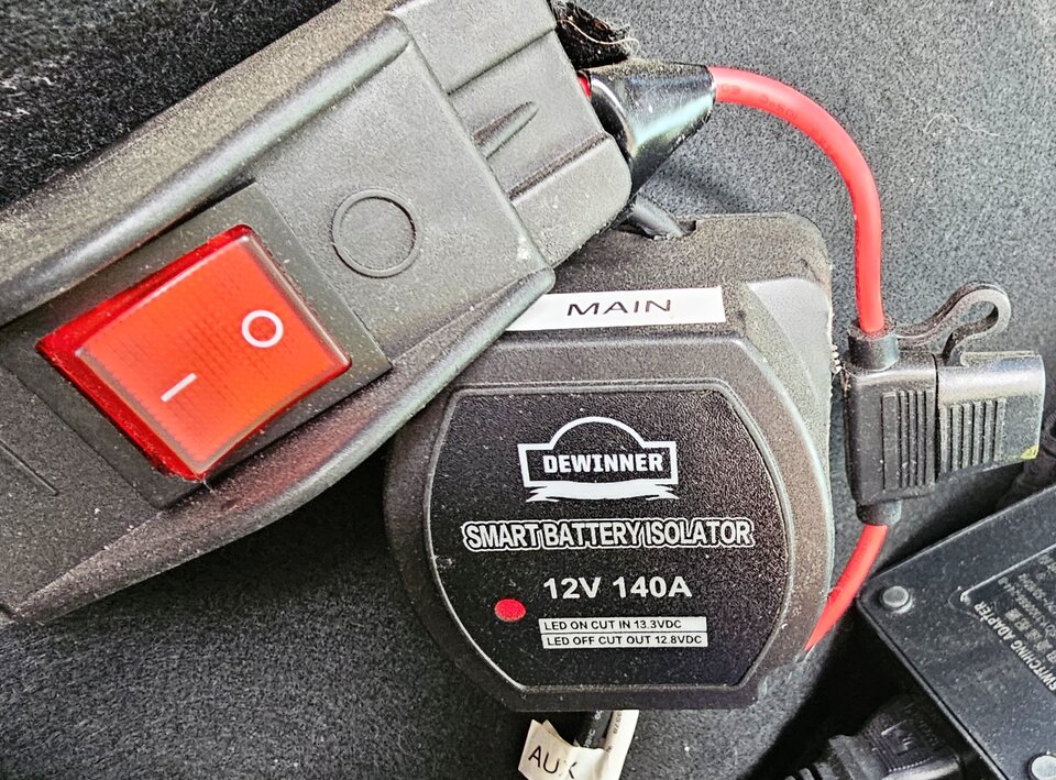

    A conventional isolator is just a bank of diodes, which lets power into the battery when it's charging, but stops it from draining. but the "smart isolator" I use cuts out at Isolator&Switch(cropped).jpg 12.8V. I use the aux battery to run a 12 V cooler in the summer, but it's also a reserve battery for boosting the system. The way I do this is to use a heavy duty toggle (40A) switch. I have a combination volt/amp meter at each end of the connection, and the current has never been excessive, probably because the connecting wires are 3m of 12 gauge wires. The resistance of that length apparently prevents the current exceeding the capacity of the switch. I also have wired in a 40 amp fuse.
    But, I discovered that the 12 V system is getting a charge while the hybrid battery is being charged. Once that is done, I disconnect the plug, and then I can use my NOCO 5 battery maintainer. I upgraded from a NOCO 2, because it wasn't keeping up with the 2.7A draw from the 12V cooler.
