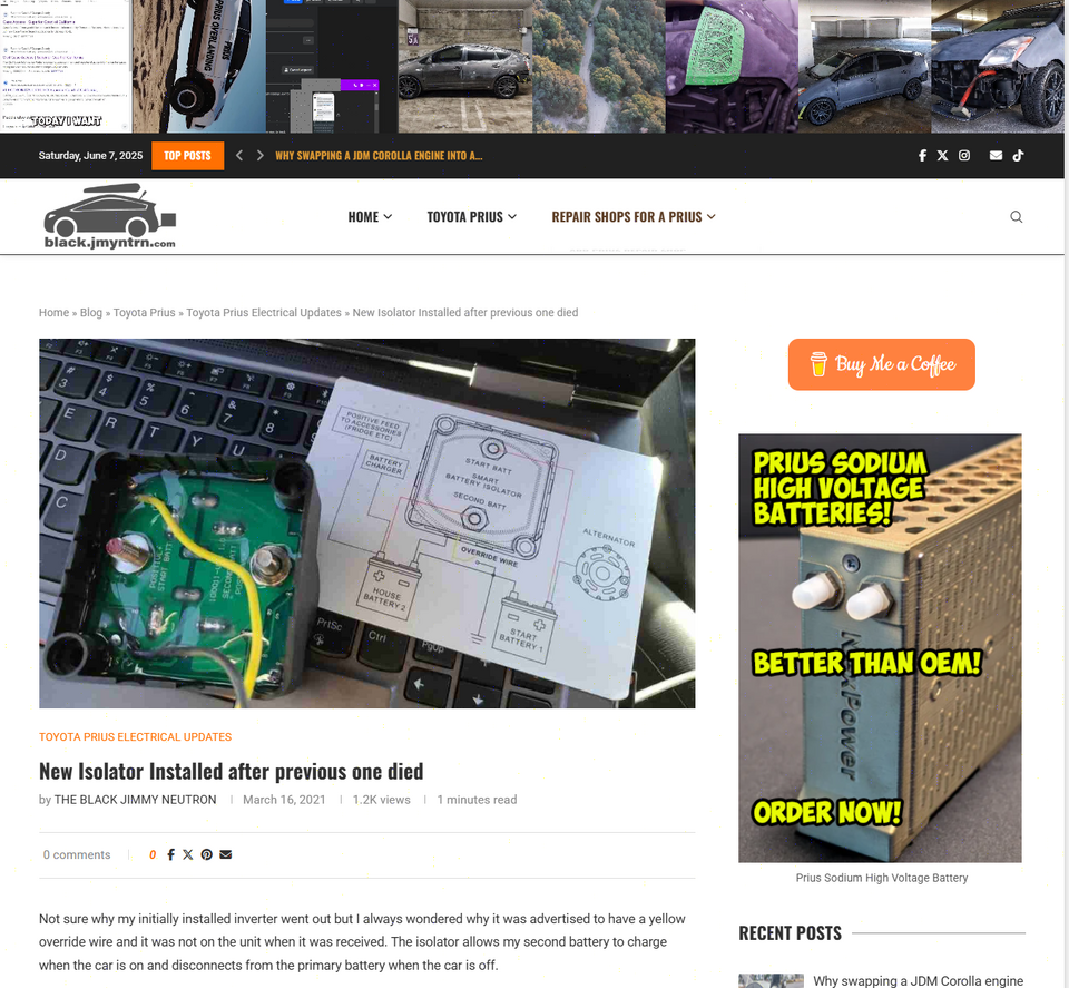

    Let me ask you this... have you used it in a dual battery setup in your prius tho? if you haven't... how can you recommend it based on looks?
    Did you read what I wrote about isolators?
    https://black.jmyntrn.com/2021/03/16/new-isolator-installed-after-previous-one-died/

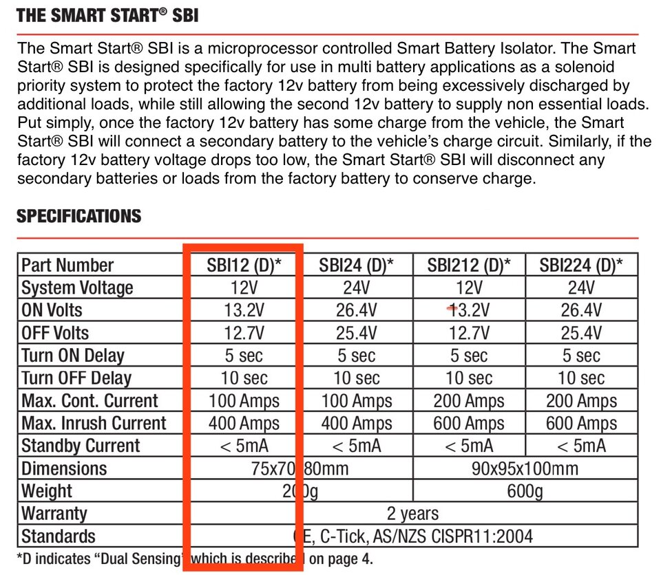

    Except I'm not using a diode isolator. The smart isolator disconnects the auxiliary battery when it reaches a level of 12.8V, and cuts in when the charging voltage reaches 13.3V.
