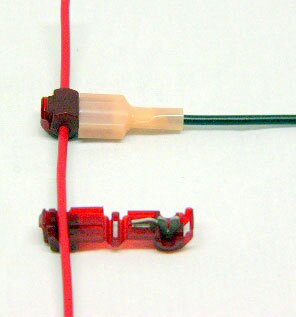

    If the bumper u got came with the harness, rhats good but ur Prii won't have the terminal for the DRLs......what u will need to do is remove the pin from the bumper harness & tap into the fuse I recommended in post #200.

    I wouldn't cut there. Go to the plug at the end of the bumper harness......now match up the pins to the end on ur Prii. There will be 1 pin missing on ur Prii plug.....this is going to be the pos pin for the DRLs on the bumper harness. Using a T-tap with a male spade, tap the wire & run it to the fuse tap. Done deal.

    If so, I would recommend doing so & cut off the pin, then either soldier on a longer wire or use a butt connector followed by marine shrink tubing for a water tight connection.
