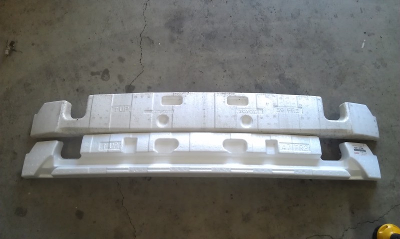

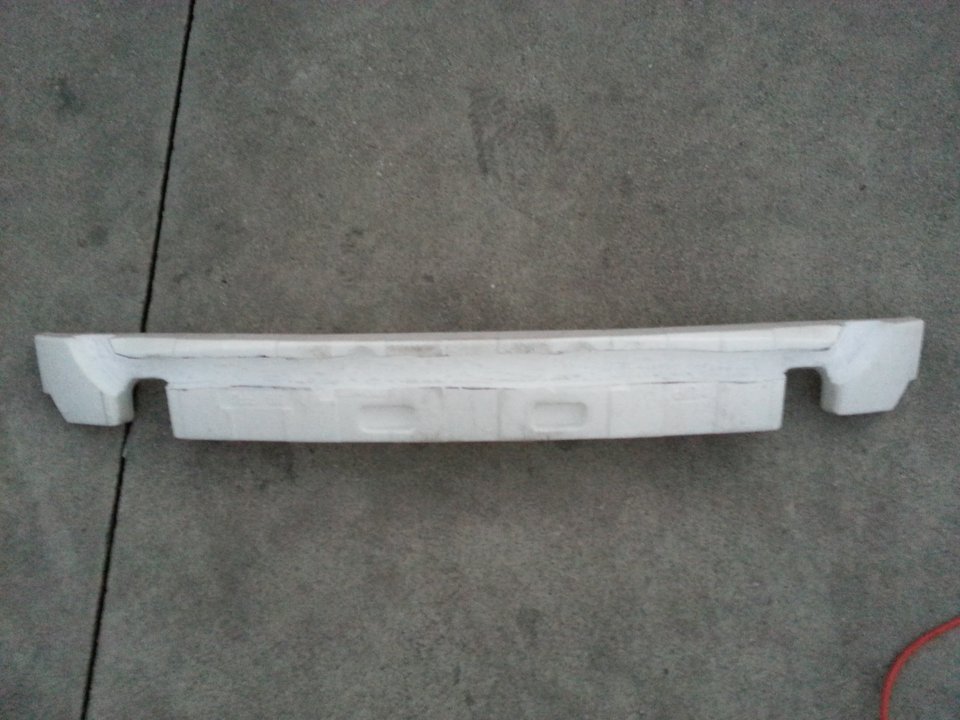

    For the front bumper I was able to use my old absorber I just had to carve it up a bit to fit the new bumper. Other than that its an exact fit. I was cheap didnt want to spend the extra $60.00. I just used a utility knife with new sharpe blade. It took about 30 min to carve it up. sfv41901 took a picture of old and new absorbers for me and I just eyeballed it and it fit perfectly.
    here is the one I carved out
    sfv41901 and Dawit like this.

  8. sfv41901
    sfv41901 Masta S
    May 5, 2010
    4,591
    5,293
    Palmdale, Ca
    Where's the final result?
  9. sfv41901
    sfv41901 Masta S
    May 5, 2010
    4,591
    5,293
    Palmdale, Ca
    Never mind.......I just saw ur pic
