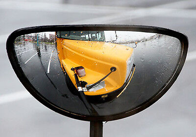

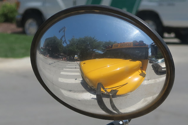

  9. Isaac Zachary
    Isaac Zachary Senior Member
    Jan 20, 2018
    2,775
    1,498
    This is what vehicles that have a hood that's too tall to see a toddler all need.
    mountaineer and daisy555 like this.
