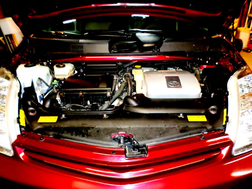

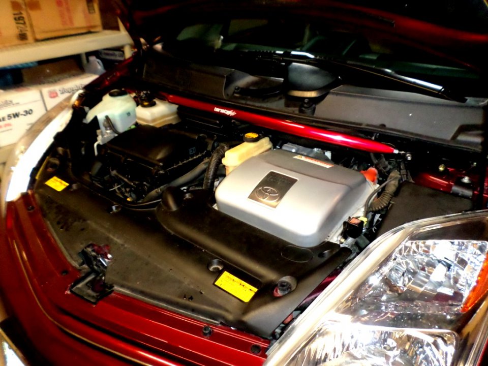

    I bought the rear Brace off Ebay for $60 and a Front strut bar for front- and wind does not move the car. The rear was a huge improvement and took 5 Minutes to install. The front looks cool and was not very expensive. Solid as a rock now. Front was: Tanabe TTB151F Sustec Front Tower Bar from Amazon $100. Prius Strut Bar.JPG
