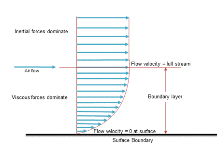

    The ground area is defined by a circle whose minimum radius is the blade length because the turbine should rotate to face the wind. Now if there is a second, near-by turbine, there needs to be a gap large enough so within a reasonable range, the turbines won't be in the other's down stream turbulence. So the area increases to handle variable wind direction. Now I understand the low W per meter square.
    Within a limited range, the parallel axis relative to the wind can be +/- 5-10 degrees. This avoids inter-turbine wind turbulence.​
    Now the blade sweeps a circle and looks like a perforated disk to the wind. This means there is a tear-drop shaped, high pressure field in front of the bade-circle that has the effect of distorting the incoming wind around what for all effective purposes is a pressure nose cone. This will divert some of the warmer air down, to the ground with a maximum effect at the disk of the rotors. Then the blade tip vortex comes into play.
    It may be possible to build a circular, earth dam with possibly a recessed dish in the center. This has the effect of pinching and increasing the ground velocity. It would like a duct increase the power produced in that part of the rotor rotation. It would not reduce the surface temperature effect as much as improving rotor power generation.​

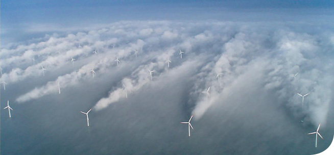

    Trailing off of each blade tip is a vortex that entraps air in a miniature tornado. This vortex drags air from the upper, warmer streams closer to the ground where another effect occurs. A vortex is attracted to a surface and thus extends further down stream from the turbine.
    There are wing tip air foils that reduce the vortex losses. The wind turbine becomes more efficient and the down-stream vortex mixing effects are reduce. ​
    Now there is one thermodynamic effect not addressed, compression and expansion of the stream. In front of the rotor disk, the air slows down due to higher pressure and is compressed. This heats the air stream. After passing through the rotor disk, the pressure is lower, cooling the flow. The effect is most pronounced at the hub but this cooled air is not tossed to the ground. So there would be temperature difference even if not measurable on the ground.
    Now if we measure the air mass through the disk, the temperature difference upstream and downstream can be used to measure the loss of energy. This energy loss should be equal to the power generated plus other losses that are not dumped into the stream.

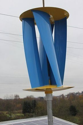

    I was thinking:
    Here you see a single level with 'end plates'. I see it on a larger scale with each stage sized for the wind velocity during night laminar flow:
