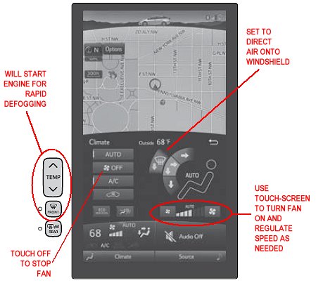

    When the front windshield defroster is activated from the buttons to the left of the display, the Prime will start its internal combustion engine to produce a lot of warm air rapidly. The engine will then run for enough time to warm up its pollution controls even if you turn the defroster off.
    I have discovered that under most circumstances, I really don't need that blast of hot air and that simple air circulation will adequately clear fog on the inside of the windshield. This can be done by using the fan control on the touch screen. Once the windshield is clear, the fan can be turned off by touching "OFF" on the screen.
    Of course, if the fogging is happening on the outside of the windshield, and the windshield wipers don't clear your view, you really need to use the engine to heat the windshield glass.
    Note: The rear windshield defroster/defogger operates using electric heat from the grid embedded inside the glass and turning it on or off will have no effect on the internal combustion engine.
