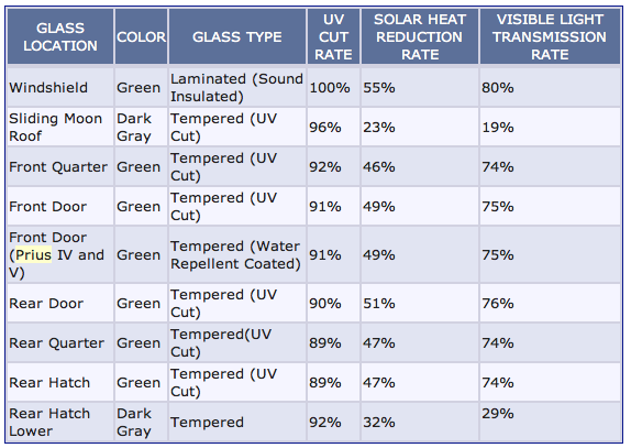

    CR90 has worse solar heat rejection (18%) than stock windshield, which is already treated to have 55% solar heat reduction in addition to 100% UV cut rate and 80% VLT. The stock windshield isn't the beast you make it out to be.

    Where can I find this info on the stock windshield?
    I think I read the Level 5 windshield has some sort of lifetime rain repellent.
    What do you know about the sunroof glass?

    You can find all the specs in 2010 Prius Window Specs | PriusChat The formatting got messed up during PC server migration so attached is an easier to read table.
    Also, the rain-repellent glass is found only on the front side windows on the Four and Five.

    Thanks for the info!
    Wow, I got rain-repellent glass on my front side windows!
    Who knew? And too bad about the low number for the moon roof..
