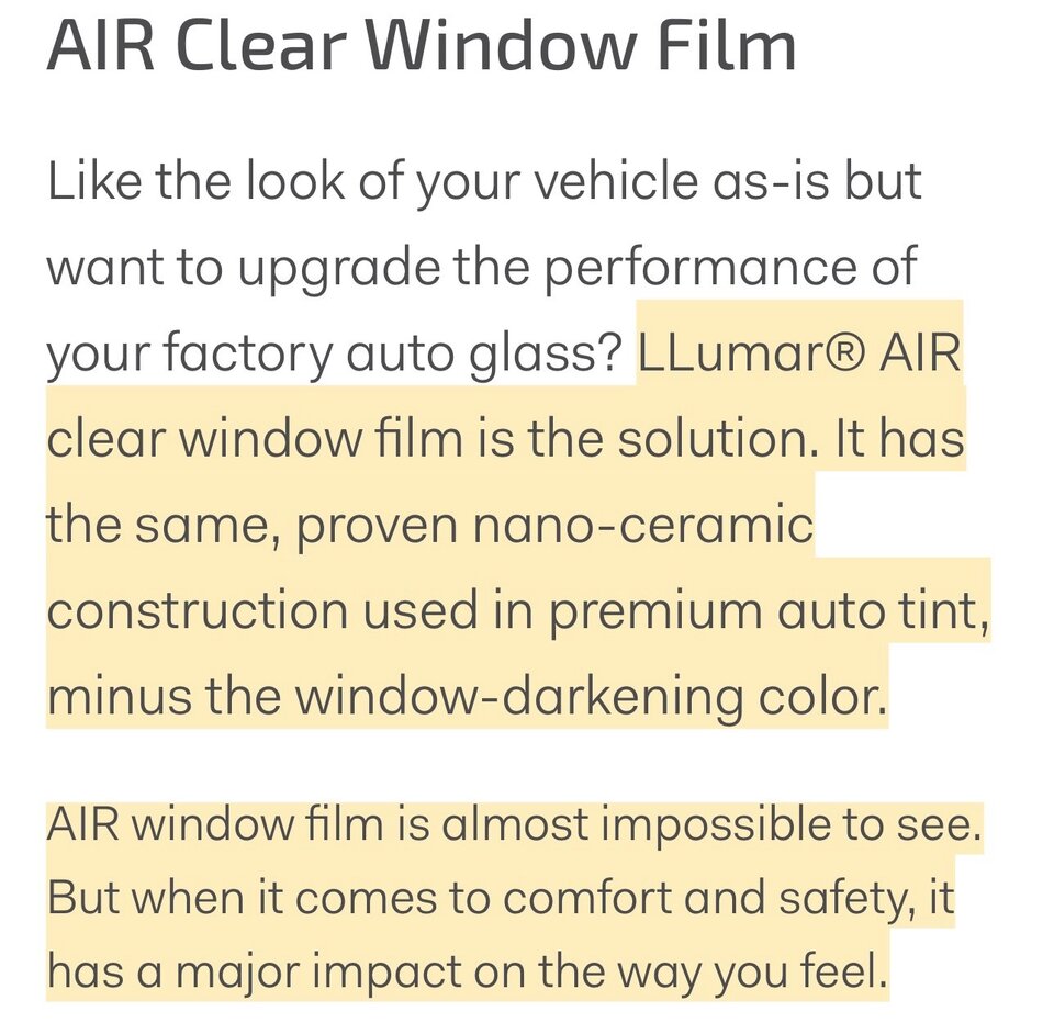

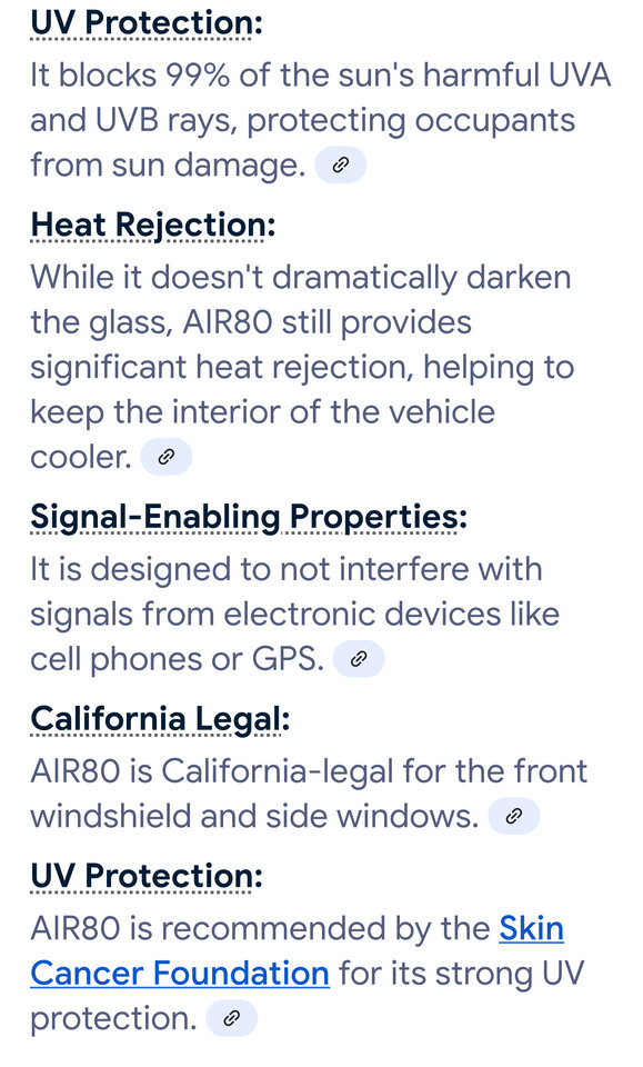

    The window film was added after purchase. It is also legal here and in California (among others) for use on windshields.

    Do you happen to remember the kind and brand of film?

    Guys in Canada and North Dakota are not up on windshield heat rejection films applied from the inside and the amazing difference it makes to uv and infrared in the southern tropics of the US.
