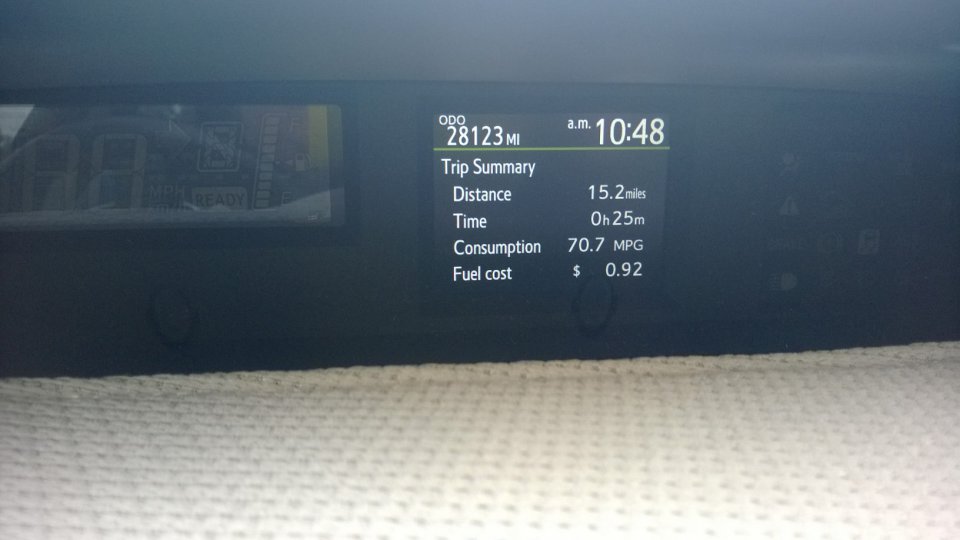

  7. orenji
    orenji Senior Member
    Aug 17, 2013
    5,887
    3,488
    Well it was 85 degrees out, A/C set on low, fan halfway, drove 25 minutes and got 70 MPG. Nothing you stated makes sense....
  8. SageBrush
    SageBrush Senior Member
    Jun 4, 2008
    11,627
    2,533
    Southwest Colorado
    The first 8 miles of my drive to work are P&G speed range.Today w/o AC I hit 88.7 mpg, although corrected for elevation it calculates out to 73.5 mpg.
    So your result makes sense to me: about a 4% fuel economy hit from AC. That is what I see too, but it is something of a minimum in my experience and requires use of the tactics I've mentioned before, and my dry climate.
